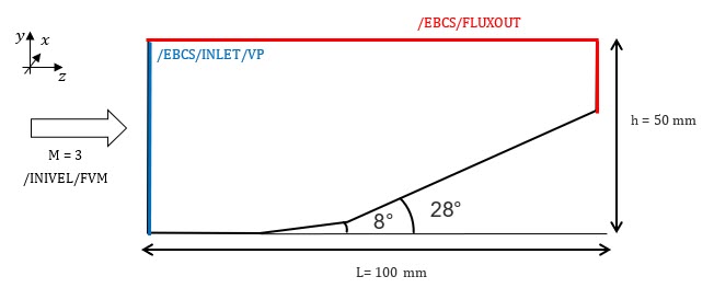

A supersonic wind tunnel (100mm length, 50 mm height) is filled with a supersonic flow Machine number (M=3) of air.
The lower wall includes two wedges of 8 degrees and 28 degrees.
The two wedges slow the flow down with the formation of shock waves.
Figure 2. Problem Description for Double Oblique Shock

Boundary Conditions
Figure 3. Boundary Condition for Double Oblique Shock
The fluid is given an initial velocity along the z-axis, defined with /INIVEL/FVM as:(1) V x = 0 m s MathType@MTEF@5@5@+= feaagKart1ev2aqatCvAUfeBSjuyZL2yd9gzLbvyNv2CaerbuLwBLn hiov2DGi1BTfMBaeXatLxBI9gBaerbd9wDYLwzYbItLDharqqtubsr 4rNCHbGeaGqiVu0Je9sqqrpepC0xbbL8F4rqGqFfpeea0xe9vq=Jb9 vqpeea0xd9q8qiYRWxGi6xij=hbba9q8aq0=yq=He9q8qiLsFr0=vr 0=vr0db8meaabaqaciGacaGaaeqabaWaaeaaeaaakeaacaWGwbWaaS baaSqaaiaadIhaaeqaaOGaeyypa0JaaGimamaalaaabaGaaiyBaaqa aiaacohaaaaaaa@3D2E@ (2) V y = 0 m s MathType@MTEF@5@5@+= feaagKart1ev2aqatCvAUfeBSjuyZL2yd9gzLbvyNv2CaerbuLwBLn hiov2DGi1BTfMBaeXatLxBI9gBaerbd9wDYLwzYbItLDharqqtubsr 4rNCHbGeaGqiVu0Je9sqqrpepC0xbbL8F4rqGqFfpeea0xe9vq=Jb9 vqpeea0xd9q8qiYRWxGi6xij=hbba9q8aq0=yq=He9q8qiLsFr0=vr 0=vr0db8meaabaqaciGacaGaaeqabaWaaeaaeaaakeaacaWGwbWaaS baaSqaaiaadIhaaeqaaOGaeyypa0JaaGimamaalaaabaGaaiyBaaqa aiaacohaaaaaaa@3D2E@ (3) V z = 1014 .18510 m s MathType@MTEF@5@5@+= feaagKart1ev2aqatCvAUfeBSjuyZL2yd9gzLbvyNv2CaerbuLwBLn hiov2DGi1BTfMBaeXatLxBI9gBaerbd9wDYLwzYbItLDharqqtubsr 4rNCHbGeaGqiVu0Je9sqqrpepC0xbbL8F4rqGqFfpeea0xe9vq=Jb9 vqpeea0xd9q8qiYRWxGi6xij=hbba9q8aq0=yq=He9q8qiLsFr0=vr 0=vr0db8meaabaqaciGacaGaaeqabaWaaeaaeaaakeaacaWGwbWaaS baaSqaaiaadQhaaeqaaOGaeyypa0deaaaaaaaaa8qacaqGXaGaaeim aiaabgdacaqG0aGaaeOlaiaabgdacaqG4aGaaeynaiaabgdacaqGWa WdamaalaaabaGaaiyBaaqaaiaacohaaaaaaa@43B6@
The value of velocity V z MathType@MTEF@5@5@+= feaagKart1ev2aqatCvAUfeBSjuyZL2yd9gzLbvyNv2CaerbuLwBLn hiov2DGi1BTfMBaeXatLxBI9gBaerbd9wDYLwzYbItLDharqqtubsr 4rNCHbGeaGqiVu0Je9sqqrpepC0xbbL8F4rqGqFfpeea0xe9vq=Jb9 vqpeea0xd9q8qiYRWxGi6xij=hbba9q8aq0=yq=He9q8qiLsFr0=vr 0=vr0db8meaabaqaciGacaGaaeqabaWaaeaaeaaakeaacaWGwbWaaS baaSqaaiaadQhaaeqaaaaa@396E@ corresponds to a speed of Mach 3, with the Mach number M MathType@MTEF@5@5@+= feaagKart1ev2aqatCvAUfeBSjuyZL2yd9gzLbvyNv2CaerbuLwBLn hiov2DGi1BTfMBaeXatLxBI9gBaerbd9wDYLwzYbItLDharqqtubsr 4rNCHbGeaGqiVu0Je9sqqrpepC0xbbL8F4rqGqFfpeea0xe9vq=Jb9 vqpeea0xd9q8qiYRWxGi6xij=hbba9q8aq0=yq=He9q8qiLsFr0=vr 0=vr0db8meaabaqaciGacaGaaeqabaWaaeaaeaaakeaacaWGnbaaaa@383A@ defined as:(4) M = V z a MathType@MTEF@5@5@+= feaagKart1ev2aqatCvAUfeBSjuyZL2yd9gzLbvyNv2CaerbuLwBLn hiov2DGi1BTfMBaeXatLxBI9gBaerbd9wDYLwzYbItLDharqqtubsr 4rNCHbGeaGqiVu0Je9sqqrpepC0xbbL8F4rqGqFfpeea0xe9vq=Jb9 vqpeea0xd9q8qiYRWxGi6xij=hbba9q8aq0=yq=He9q8qiLsFr0=vr 0=vr0db8meaabaqaciGacaGaaeqabaWaaeaaeaaakeaacaWGnbGaey ypa0ZaaSaaaeaacaWGwbWaaSbaaSqaaiaadQhaaeqaaaGcbaGaamyy aaaaaaa@3C46@
Where, a MathType@MTEF@5@5@+= feaagKart1ev2aqatCvAUfeBSjuyZL2yd9gzLbvyNv2CaerbuLwBLn hiov2DGi1BTfMBaeXatLxBI9gBaerbd9wDYLwzYbItLDharqqtubsr 4rNCHbGeaGqiVu0Je9sqqrpepC0xbbL8F4rqGqFfpeea0xe9vq=Jb9 vqpeea0xd9q8qiYRWxGi6xij=hbba9q8aq0=yq=He9q8qiLsFr0=vr 0=vr0db8meaabaqaciGacaGaaeqabaWaaeaaeaaakeaacaWGHbaaaa@384E@ is the sound velocity, which is computed as:(5) a = γ P ρ MathType@MTEF@5@5@+= feaagKart1ev2aqatCvAUfeBSjuyZL2yd9gzLbvyNv2CaerbuLwBLn hiov2DGi1BTfMBaeXatLxBI9gBaerbd9wDYLwzYbItLDharqqtubsr 4rNCHbGeaGqiVu0Je9sqqrpepC0xbbL8F4rqGqFfpeea0xe9vq=Jb9 vqpeea0xd9q8qiYRWxGi6xij=hbba9q8aq0=yq=He9q8qiLsFr0=vr 0=vr0db8meaabaqaciGacaGaaeqabaWaaeaaeaaakeaacaWGHbGaey ypa0ZaaOaaaeaadaWcaaqaaiabeo7aNjaadcfaaeaacqaHbpGCaaaa leqaaaaa@3DBB@ (6) a = 338 m s MathType@MTEF@5@5@+= feaagKart1ev2aqatCvAUfeBSjuyZL2yd9gzLbvyNv2CaerbuLwBLn hiov2DGi1BTfMBaeXatLxBI9gBaerbd9wDYLwzYbItLDharqqtubsr 4rNCHbGeaGqiVu0Je9sqqrpepC0xbbL8F4rqGqFfpeea0xe9vq=Jb9 vqpeea0xd9q8qiYRWxGi6xij=hbba9q8aq0=yq=He9q8qiLsFr0=vr 0=vr0db8meaabaqaciGacaGaaeqabaWaaeaaeaaakeaacaWGHbGaey ypa0JaaG4maiaaiodacaaI4aWaaSaaaeaacaGGTbaabaGaai4Caaaa aaa@3D88@
When using /MAT/MULTIFLUID, the default boundary conditions are sliding walls.
A non-reflecting inlet is defined using /EBCS/INLET/VP. Input density and pressure are defined for the air in the multi-material law.
A non-reflecting boundary is defined with /EBCS/FLUXOUT.

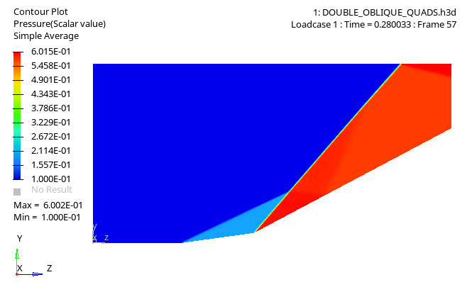

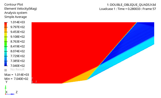

It is interesting to take a look at pressure element velocity and density once steady-state is reached.
Figure 4. Contour for Elemental Velocity
Figure 5. Contour for Elemental Pressure

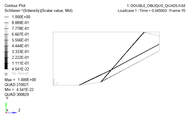

The Schlieren contour highlights the shock fronts. To improve the view of the shock waves from the Schlieren output, advanced math was used in HyperView. The /H3D/ELEM/SCHLIEREN output was raised to the 5th power and the legend changed to greyscale with black at the minimum and white for the maximum value.
Figure 6. Schlieren Output to the Power of (5/density)

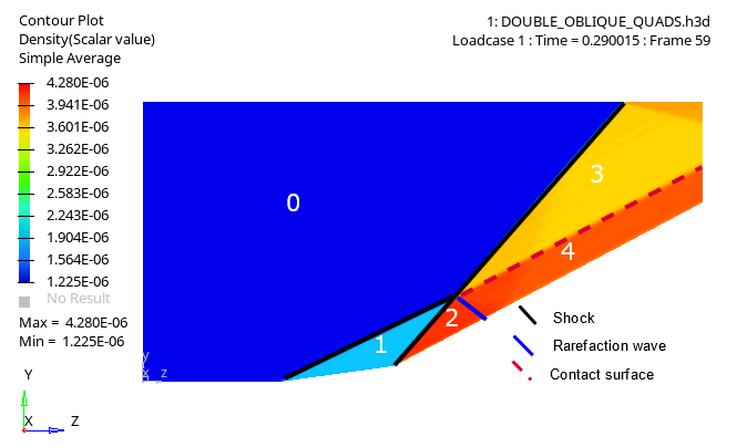

The shock front shown in Figure 7 divides the flow into four states as each shock front slows down and recompresses.
Figure 7. Shock Fronts and Density Map Showing the different States
Fluid particles close to the wall go through two shock fronts, while those away from the wall see only one. However, it is stronger, so flow quantities in State 3 differ from State 2. State 2 and State 4 are separated by a verification wave, with allows for a pressure equilibrium between States 3 and 4. All other quantities are otherwise discontinuous between State 3 and State 4, as the two are separated by a contact wave.

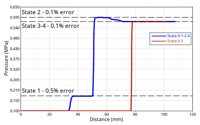

The spatial profile for pressure and mass density on these two nodes paths are visible on Figure 10 and Figure 11. Each flat on the curves corresponds to one the flow states described above. The value of the thermodynamic quantities obtained from the model can then be compared to those determined analytically.
Figure 10. Pressure Profile in Steady-State. with the value of the relative error to the analytical value
Figure 11. Mass Density Spatial Profile in Steady-State. with the value of the relative error to the analytical value
