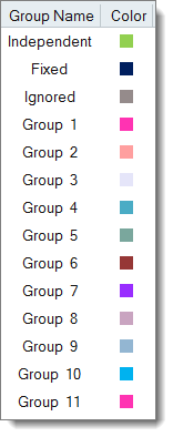

- Independent: All the lines are independent, that is, each one of them will have their own unique length and they will optimized by the solver independently. These lines will be green in color. This group cannot be deleted by the user, however, it can be empty. Initially all lines are assigned to this group.
- Fixed: All the lines are independent and have a fixed length, that is, length of these lines will not be changed by the solver. These lines will be dark blue in color. This group cannot be deleted by the user, however, it can be empty.
- Ignored: All the lines in this group are ignored by the interface and they will not be exported. These lines are grey in color. This group cannot be deleted by the user, however, it can be empty.

Color Codes
