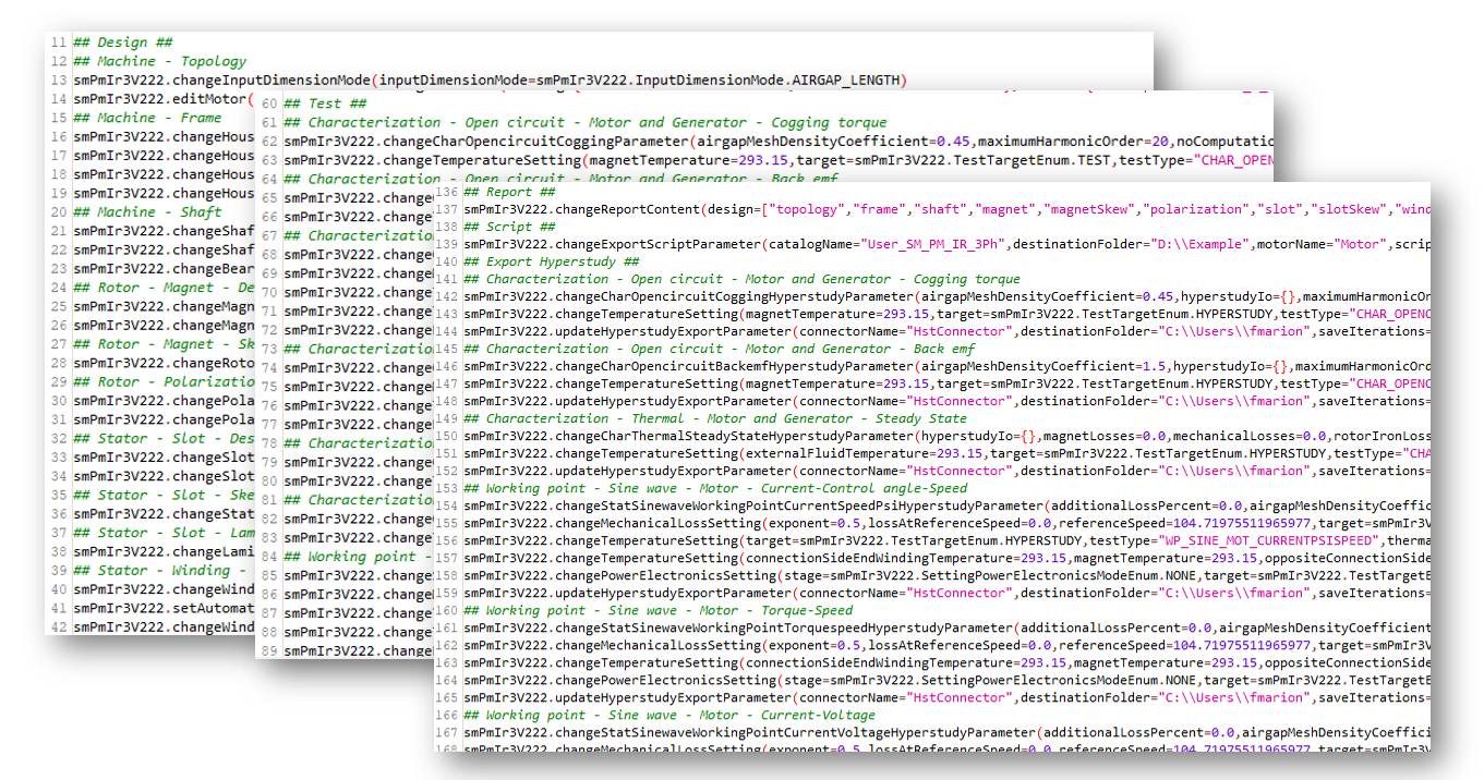

Concerning the process, either you get the script (python file) or you can get into “Script Factory” directly and instantaneously to work on it.
Here an example is shown below for the provided python script in which are described all the sections to define the design of the motor, the tests and the exports which can be performed.
This is a very powerful way for keeping all the information for rebuilding motors, whatever will be the used version of FluxMotor.
| Example of python script in which are described all the sections to define the design of the motor, the tests and the exports which can be performed |

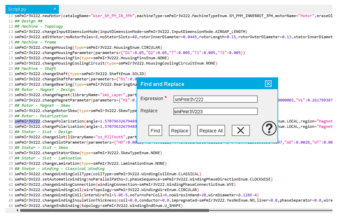

Functions are implemented for helping the management of python files like “Find and Replace”, Edit, Copy, Paste, Delete,...
| Function “Find and Replace” is available |
