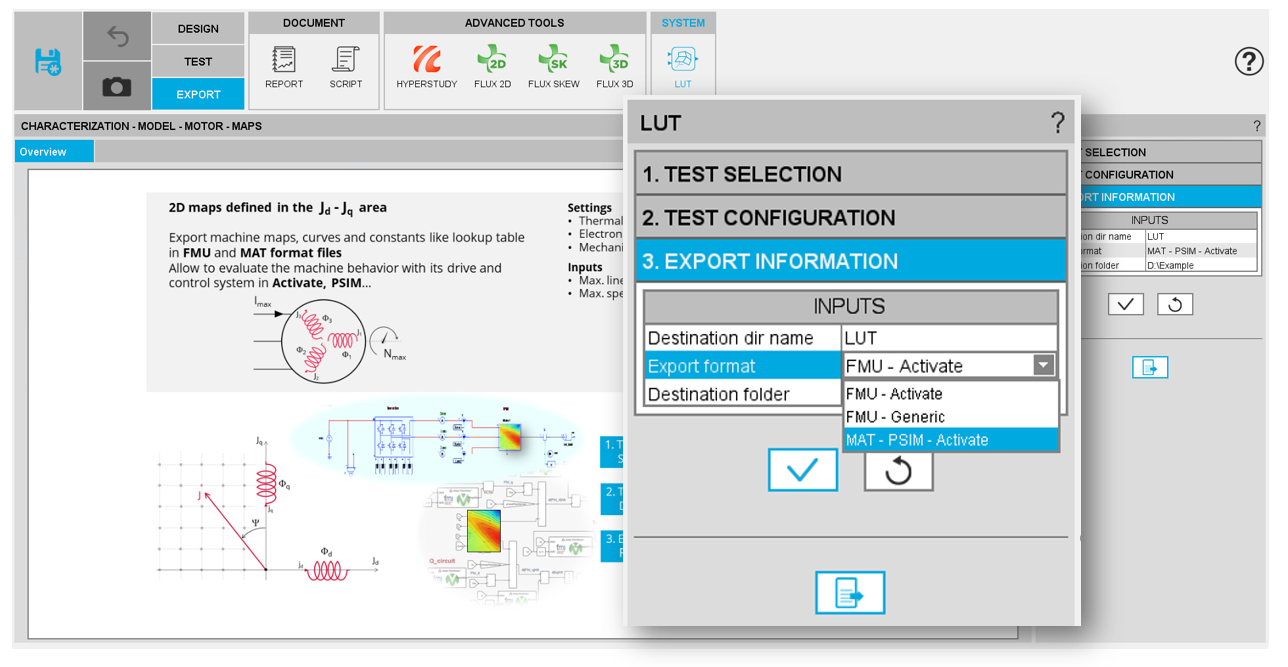

A new Export / SYSTEM environment for providing LUT
In the current version, and in near future, one big target is to develop and export more and more machine models, like lookup table (LUT), from FluxMotor to Activate and PSIM.
A new area is now dedicated to export LUT using both FMU or MAT format files to be used in Activate, PSIM or other system software.
| A new area is now dedicated to export LUT |
In the EXPORT / ADVANCED TOOLS environment, “FORMAT/ FMU” has been removed and replaced by the new one: “SYSTEM / LUT”.
Like in the previous version, the users can export FMU format files dedicated for Activate® by selecting the input “FMU – Activate” or compatible with other system simulation tools with the input “FMU – Generic”.
But now these can also export MAT format files dedicated to Activate as well as PSIM by selecting the input “MAT – PSIM – Activate”
| Export formats which are available for exporting LUT |

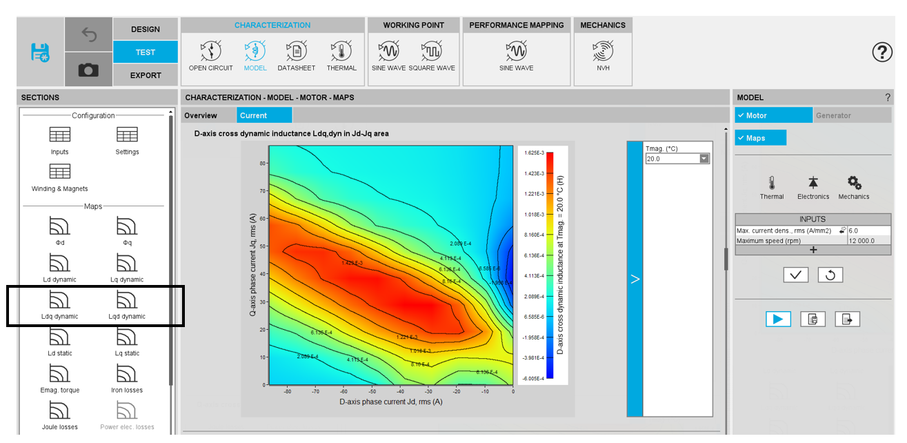

The data which can be exported are mainly based on what is computed in the test Characterization / Model / Maps.
| D-Axis and Q-Axis cross dynamic inductances are computed and displayed in the test Characterization / Model / Maps |
