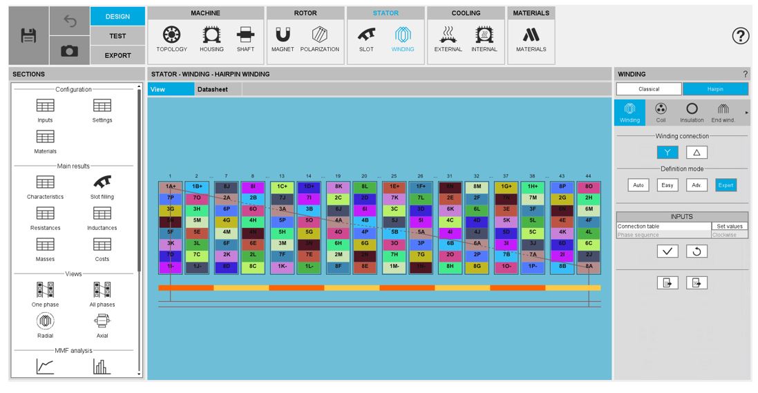

Here is the home page below, for designing both classical and hairpin winding.
The main principles of GUI are similar in both kind of windings, classical and hairpin.
As for a classical winding, dedicated section help users to define the winding architecture, the coil, the electrical insulations, the end-winding, and the potting.
| WINDING design area – Area dedicated to Hairpin winding topology – In standard mode |

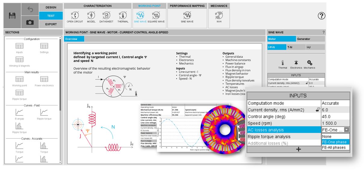

| Tests are available for computing performance of machines with hairpin winding topology Motor Factory – TEST area |

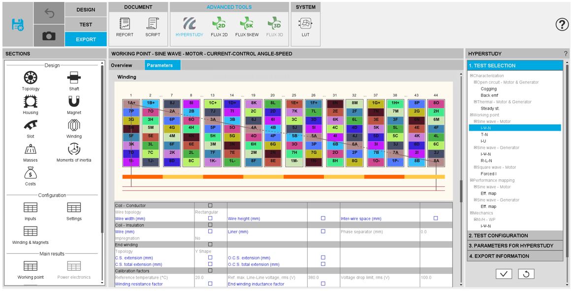

| Optimisation of machines with hairpin winding topology is possible – Motor Factory – EXPORT area |
