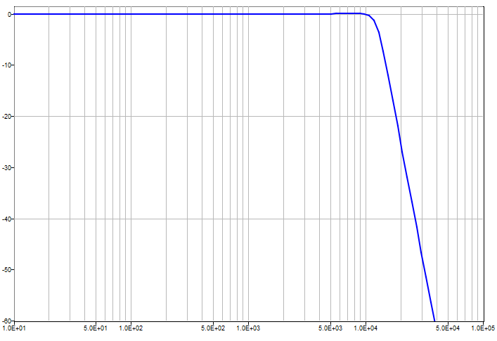

Example
Plot the U weights in decibels with log spacing for frequency.
freq = logspace(1,5,100);
mag = ones(1,length(freq));
output = dbu(freq, mag);
semilogx(freq, output);
Figure 1. dbu figure 1
Comments
U-weighting dampens the ultra-sonic components of the input curve. Output is not converted to decibels, which can be done when plotting.
The magnitude vector is divided by the reference and then weighted.
