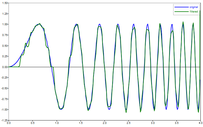

Example
Use stft/istft to remove frequency components with low magnitudes from a linear chirp signal.
f0 = 0;
f1 = 5;
T = 4;
c = (f1 - f0) / T;
t = [0:0.01:T-0.01];
x1 = sin(2 * pi * ((c/2)*t.^2 + f0*t));
[st, t_st, f] = stft(x1, 100, 20, 10, 32, 'onesided');
idx = (abs(st) > 2.5);
st = st .* idx;
x2 = istft(st, 100, 20, 10, 32, 'onesided');
plot(t, x1);
hold on;
plot(t, x2);
legend('original', 'filtered');
Figure 1. istft figure 1
