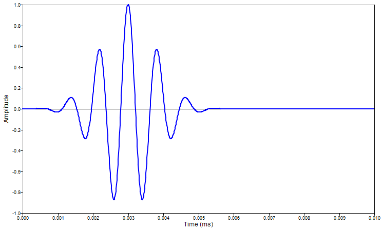

Example
Plot a pulse with a 1200 Hz center frequency and a 0.4 fractional bandwidth, centered at t=3 ms on a 10 ms interval, sampled at 100 KHz.
t = [0:0.01:10] * 0.001;
p = gauspuls(t - 0.003, 1200, 0.4);
plot(t, p);
xlabel ('Time (ms)');
ylabel ('Amplitude');
Figure 1. gauspuls figure 1
