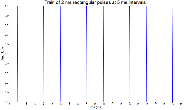

Example 1
Plot a train of 2 ms rectangular pulses at 5 ms intervals.
fs = 20000;		% sampling rate of the output
ts = 1 / fs;
fp = 200;		% pulse rate
tp = 1 / fp;
t = [0:ts:4*tp];
d = [0:tp:4*tp];
w = .4 * tp;
p = pulstran (t, d, 'rectpuls', w);
plot(1000 * t, p);
title ('Train of 2 ms rectangular pulses at 5 ms intervals');
xlabel ('Time (ms)');
ylabel ('Amplitude');
Figure 1. pulstran figure 1

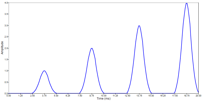

Example 2
Plot a train of user defined at 5 ms intervals, with increasing amplitude.
fs = 10000;		% sampling frequency of the output
ts = 1 / fs;
fp = 200;		% pulse frequency
tp = 1 / fp;
t = [0:ts:4*tp];
d = [0:tp:4*tp] + 0.5*tp;
np = length(d);
d = [d',[1:np]'];
p = [0.010 0.134 0.409 0.800 1.000 0.800 0.409 0.134 0.010];
fsp = 3200;		% sampling frequency of p
x = pulstran (1000 * t, d, p, fsp, 'pchip');
plot(t, x);
Figure 2. pulstran figure 1
