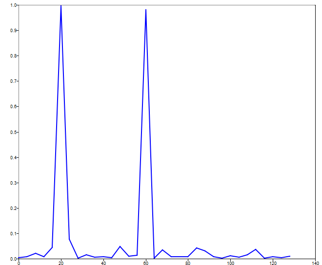

Example
Coherence of two signals sharing common frequency components.
n = 4096;
fs = 256;
ts = 1/fs;
t = [0:ts:(n-1)*ts];
w1 = 2*pi*20;
w2 = 2*pi*32;
w3 = 2*pi*48;
w4 = 2*pi*60;
signal1 = 5*cos(w1*t) + 7*cos(w2*t) + 3*cos(w4*t);
signal2 = 7*cos(w1*t + (pi/2)) + 5*sin(w3*t) + 2*cos(w4*t + pi);
rand('seed', 2019);
signal1 = signal1 + randn(1, n);
signal2 = signal2 + randn(1, n);
window = ones(1, 64);
mscohere(signal1, signal2, window, 0, [], fs);
Figure 1. impz figure 1

With no return arguments, the function will automatically plot.
