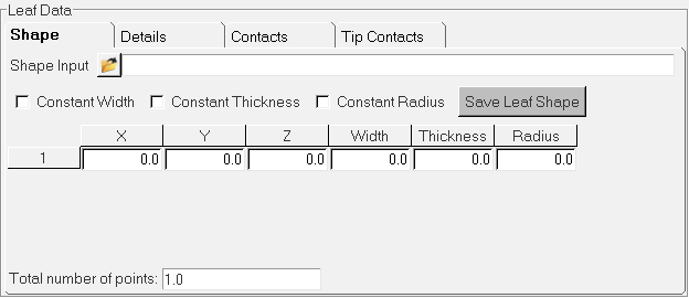

  2. From the Leaf Data section, browse and select the Leaf_1.csv file for the Shape Input field.
    You can also specify the required values for the X coordinate, Z coordinate and width and thickness variation manually for the leaf profile.
    Tip: If the leaf is a constant thickness (and/or width), you need to specify the values only in the first row. The same value will be used along the entire length of the leaf.
    The Leaf 1 graphics are displayed in the Canvas section.

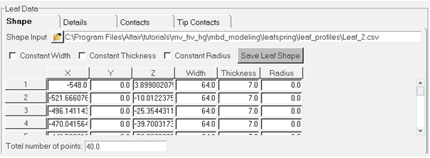

  1. From the Leaf Spring Components browser section, click the Leaf 2 component.
  2. Enter the required data for Leaf 2 in the Shape tab of the Property Editor as shown in Figure 17.
    1. From the Shape Input field, browse and select the Leaf_2.csv file.
    2. For Width, enter 64.
    3. For Thickness, enter 7.
    The Leaf 2 graphics are displayed in the Canvas section.

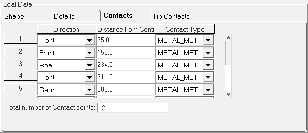

  4. Open the Contacts tab.
  5. For the Total number of Contact points, enter 12 and press Enter.
    The Contacts table for Leaf 2 is generated based upon the values entered.
  6. Enter the data shown in Table 2 into the Contacts table.
    Table 2.
    S. No Direction Distance Contact Type
    1 Front 95 METAL_METAL
    2 Front 155 METAL_METAL
    3 Front 234 METAL_METAL
    4 Front 311 METAL_METAL
    5 Front 385 METAL_METAL
    6 Front 457 METAL_METAL
    7 Rear 105 METAL_METAL
    8 Rear 155 METAL_METAL
    9 Rear 234 METAL_METAL
    10 Rear 311 METAL_METAL
    11 Rear 385 METAL_METAL
    12 Rear 457 METAL_METAL
    The entered contact points are plotted on Leaf 2 and are displayed in the Canvas section.
