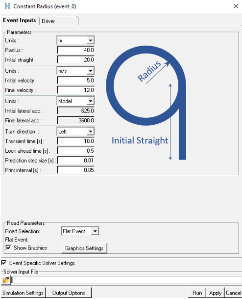

  3. Open the Event Editor dialog by right-clicking on the ConstantRadius 0 event from the Project Browserand select Edit Event from the context menu.
    The Constant Radius event's parameter is displayed.
  4. Enter the necessary information in the Constant Radius event's parameter.
    1. Change the Units to meters (m).
    2. For Radius [m], enter 40.
    3. For Initial straight [m], enter 20.
    4. For Initial velocity [m/s], enter 5.
    5. For Final velocity [m/s], enter 12.
    6. From the Turn direction drop-down menu, select Left.
    7. For Transient time [s], enter 10.
    8. For Look ahead time [s], enter 0.5.
    9. For Prediction step size, enter 0.01.
    10. For Print interval [s], enter 0.05.
    11. From the Output XML File, browse and select the file path.
    Figure 23.
  5. Click the Run button.
    An ADF (Altair Driver File) is generated with all the event parameters at the XML file path (Output XML File) location. The model is exported and MotionSolve starts to generate the result files. HyperWorks MotionSolve is invoked in the background.
