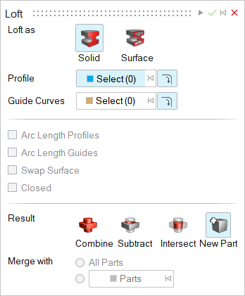

The guide panel appears.
Choose the entity type that you'd like to create:
- Solids: Loft as a solid.
- Surfaces: Loft as a surface.

Choose a Result type:
- Merge (only available for Solids): Merge the loft with the existing parts.
- Subtract (only available for Solids): Carve out the loft from the existing parts.
- Intersect (only available for Solids): Retain only the intersecting portions of the loft and the existing parts.
- New Part: Create a new part from the loft.
If you selected Solids, choose a
Merge method:
- All Parts (default): Merge the loft with all parts that touch it.
- Parts: Select the radio button to merge the loft with selected parts. Then select the parts that you’d like to merge the loft with.
- Click Apply.
