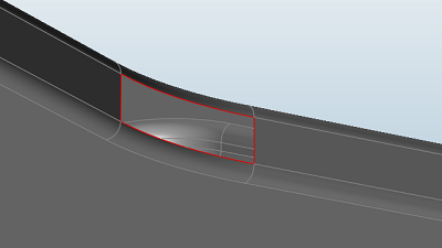

If the Patch tool finds a group of open edges that define a closed loop, clicking a red edge will close the hole.

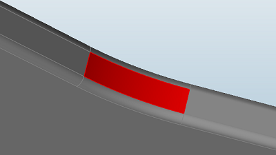

Figure 1. Patched Surface

Patch open areas that define a closed loop, or create a bridge between two open edges that do not define a closed area.

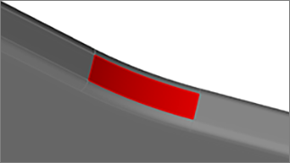

Figure 3. Overlapping Surfaces Shown in Red

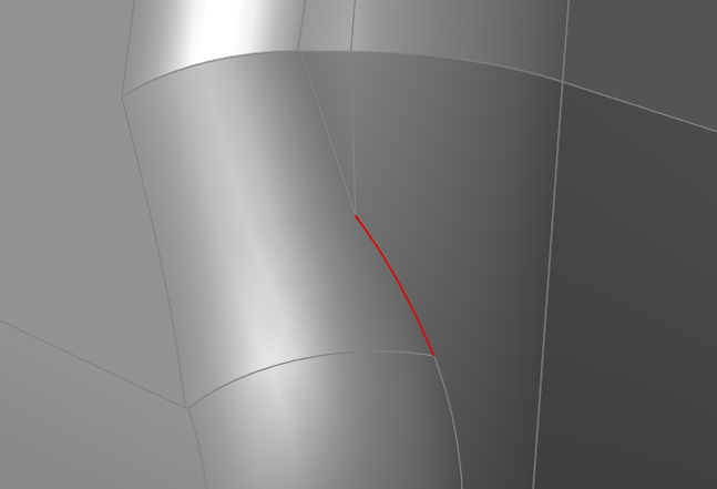

Select open edges individually to define an area to patch.
