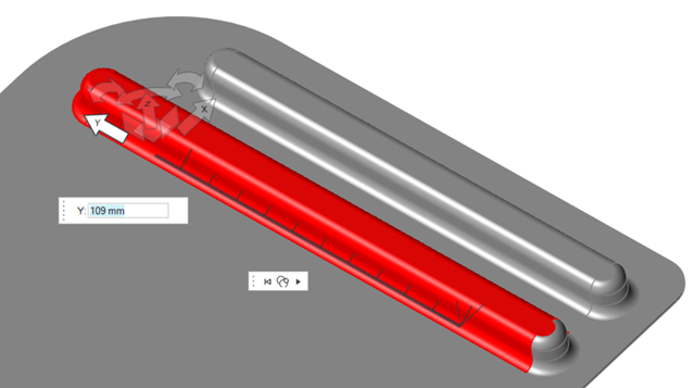

Move Faces
Translate, rotate, copy, or extend features.
Move Features
Move holes, pockets, and surface features.

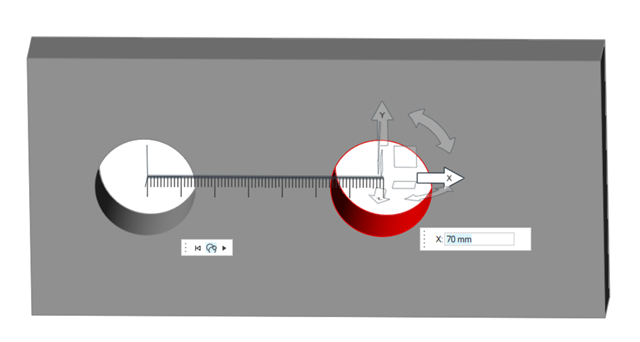

Copy Features
Copy holes, pockets, and surface features.
