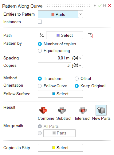

Pattern Along Curve
Pattern parts or faces along a path, which can be an edge, curve, sketch, or wire.
On the Geometry ribbon, in the
Pattern tool group, select the Pattern
Along Curve tool.
The guide panel appears.
Choose the type of Entities to Pattern:
- PartsNote: To make all of the parts in the pattern instances of the original part, turn on Instances.
- Faces
- Parts
In the modeling window, select one or more parts or faces.
Note: To deselect a feature, hold down Ctrl while clicking. To clear all selected features, in the microdialog click Clear Selection.
Define the path:
- In the guide panel, next to Path, click the Select button.
- In the modeling window, select an edge, curve, sketch, or wire to that pattern will follow.
- (Optional): To reverse the direction, click
in the guide panel. - (Optional): Select
Tangent Propagation
so that clicking an edge will also select all of its tangent edges.
Select a pattern method:
- Number of copies: Select this option to specify the Spacing between each copy and the Number of Copies.
- Equal spacing: Select this option to equally space the copies within a specified Spacing.
Adjust the pattern:
To Do this Change the number of copies Enter the number of Copies. Change the spacing between each copy Enter the Spacing. -
Choose a Method for maintaining the distance between the
curve and the original entity:
- Transform: For each copy, maintain the relative distance between the curve and the original entity.
- Offset: For each copy, maintain the normal distance between the curve and the original entity.
Choose an Orientation for the copies:
- Follow Curve: Align each copy so that it follows the curve.
- Keep Original: Align each copy to the original entity, so they have the same orientation.
To make the pattern follow a surface:
- Next to Follow Surface, click the Select button.
- Select a face to make the copies normal to it.
(Parts only) Choose a Result type:
- Combine: Combine the patterned parts with the existing parts.
- Subtract: Carve out the patterned parts from the existing parts.
- Intersect: Retain only the intersecting portions of the patterned parts and the existing parts.
- New Part: Create new parts from patterned parts.
(Parts only) If you selected Combine,
Subtract, or Intersect, choose
a Merge method:
- All Parts (default): Merge the patterned parts with all touching parts.
- Parts: Select the radio button to merge the patterned parts with selected parts. Then select the parts that you’d like to merge the patterned parts with.
- Optional:
Select the copies to skip:
- Next to Copies to Skip, click the Select button.
- Select the copies to exclude from the pattern.
- Click Apply.
