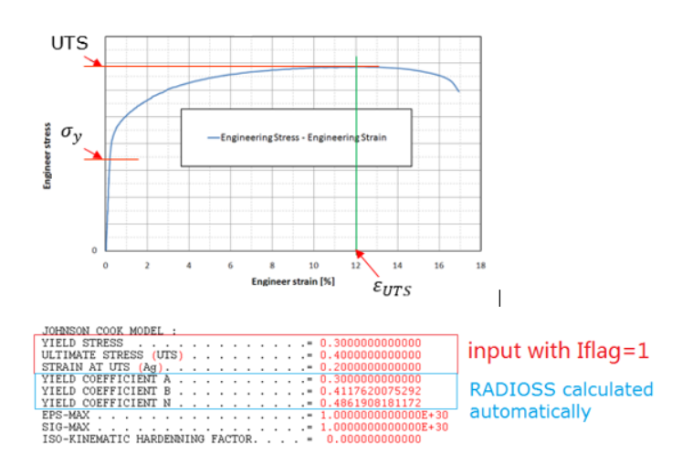

Iflag = 1
With this new input, you will need yield stress ( σ y ), Ultimate tensile engineer stress (UTS) and engineer strain ( ε UTS MathType@MTEF@5@5@+= feaagKart1ev2aqatCvAUfeBSjuyZL2yd9gzLbvyNv2CaerbuLwBLn hiov2DGi1BTfMBaeXatLxBI9gBaerbd9wDYLwzYbItLDharqqtubsr 4rNCHbGeaGqiVu0Je9sqqrpepC0xbbL8F4rqqrFfpeea0xe9Lq=Jc9 vqaqpepm0xbba9pwe9Q8fs0=yqaqpepae9pg0FirpepeKkFr0xfr=x fr=xb9adbaqaaeGaciGaaiaabeqaamaabaabaaGcbaGaeqyTdu2aaS baaSqaaiaadwfacaWGubGaam4uaaqabaaaaa@3A55@ ) at necking point. With this new input, Radioss automatically calculates the equivalent value for a MathType@MTEF@5@5@+= feaagKart1ev2aqatCvAUfeBSjuyZL2yd9gzLbvyNv2CaerbuLwBLn hiov2DGi1BTfMBaeXatLxBI9gBaerbd9wDYLwzYbItLDharqqtubsr 4rNCHbGeaGqiVu0Je9sqqrpepC0xbbL8F4rqqrFfpeea0xe9Lq=Jc9 vqaqpepm0xbba9pwe9Q8fs0=yqaqpepae9pg0FirpepeKkFr0xfr=x fr=xb9adbaqaaeGaciGaaiaabeqaamaabaabaaGcbaGaamyyaaaa@36DD@ , b MathType@MTEF@5@5@+= feaagKart1ev2aqatCvAUfeBSjuyZL2yd9gzLbvyNv2CaerbuLwBLn hiov2DGi1BTfMBaeXatLxBI9gBaerbd9wDYLwzYbItLDharqqtubsr 4rNCHbGeaGqiVu0Je9sqqrpepC0xbbL8F4rqqrFfpeea0xe9Lq=Jc9 vqaqpepm0xbba9pwe9Q8fs0=yqaqpepae9pg0FirpepeKkFr0xfr=x fr=xb9adbaqaaeGaciGaaiaabeqaamaabaabaaGcbaGaamyyaaaa@36DD@ and n MathType@MTEF@5@5@+= feaagKart1ev2aqatCvAUfeBSjuyZL2yd9gzLbvyNv2CaerbuLwBLn hiov2DGi1BTfMBaeXatLxBI9gBaerbd9wDYLwzYbItLDharqqtubsr 4rNCHbGeaGqiVu0Je9sqqrpepC0xbbL8F4rqqrFfpeea0xe9Lq=Jc9 vqaqpepm0xbba9pwe9Q8fs0=yqaqpepae9pg0FirpepeKkFr0xfr=x fr=xb9adbaqaaeGaciGaaiaabeqaamaabaabaaGcbaGaamyyaaaa@36DD@ .
Figure 2. Tension Test

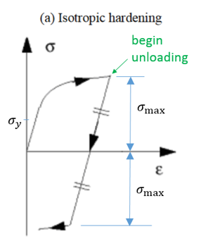

Chard = 0: Isotropic Model
In a one dimension case, material strengthens after yield stress. The maximum stress of the last tension is the yield in the subsequent loading, and this new yield stress is the same in subsequent tension and compression.

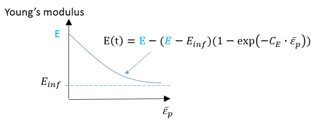

Young's Modulus
Young's modulus can be updated (decreased) in unloading with options fct_IDE, Einf and CE. Using this feature improves the accuracy of spring-back (in unloading phase) for high strength steel. This feature is also available in material LAW43, LAW57, LAW60, LAW74 and LAW78.
  • Use fct_IDE to update the Young's modulus (fct_IDE ≠ 0):
  • Use Einf and CE to update the Young's modulus (fct_IDE = 0):

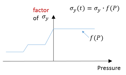

fct_IDp is used to distinguish the behavior in tension and compression for certain materials (pressure dependent yield). The effective yield stress is then obtained by multiplying the nominal yield stress by the yield factor corresponding to the actual pressure.
