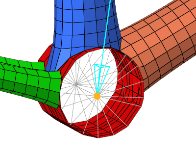

In the modeling window, select the node where the crank
load is applied.
Figure 9. -

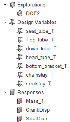

As an exercise, try creating a similar DOE where the gauge of every component
is a design variable. Your DOE and reports should look something like the
following (your actual values will vary, based on your specific design variable
bounds choices).
Figure 19.
