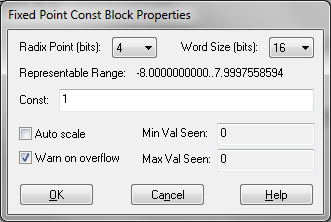

The Fixed Point Const dialog lets you manipulate the const value, word size, and radix point.
The dialog also shows the Representable Range; that is, the range of acceptable values based on the Radix Point and Word Size parameters. Increasing the Radix Point value increases the range; decreasing the value, decreases the range.
