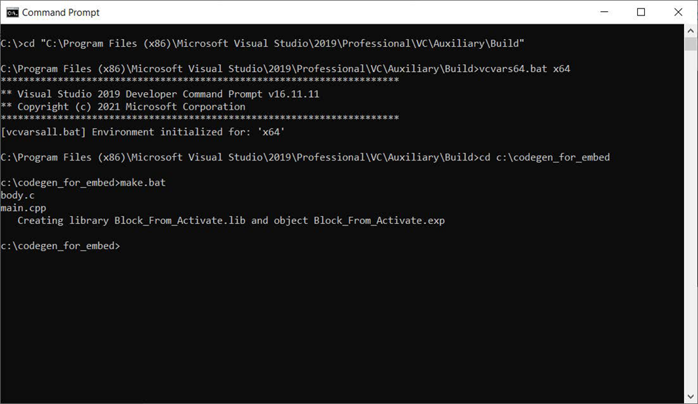

  5. Open a command prompt and change the directory to the Visual Studio Build folder.
  6. Set up the compiler environment. For example, for 64-bit Visual Studio, call vcvars64.bat x64.
  7. Change directory to the code generation output directory, and then call make.bat.
    If there are no errors, the invocation of the make.bat produces a dll that can be further registered in Embed.

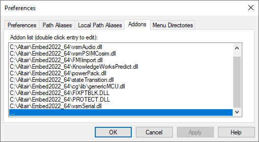

After the DLL has been created, add it to Embed as an addon.
  1. Open Activate Embed.
  2. Select Edit > Preferences.
  3. Open the Addons tab, and then double-click ... at the bottom of the list.
  4. Browse to the location of the DLL you created in the export steps, and then select it.
    The DLL is added to the bottom of the Addons list.
  5. Select the DLL from the list, and then click OK.

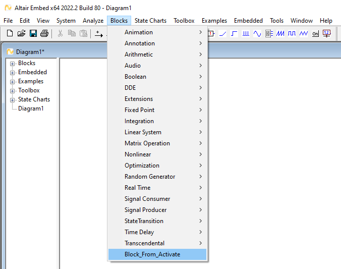

    The new block is added to the Blocks menu.
    You can use the new block for simulation and code generation.
