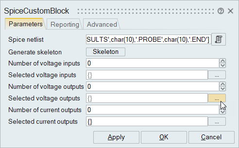

  2. From the Palette Browser > Activate > CustomBlocks, drag one SpiceCustomBlock into your diagram and double-click it.
  3. From the Parameters tab, select the SPICE Netlist button.
    The Spice Netlist Editor appears.

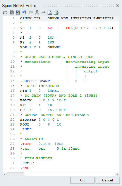

  4. Copy the code from the OP_NON.cir file and paste it into the Spice Netlist Editor.
  5. Click OK.
  6. From the Parameters tab, select the button to define the Selected voltage outputs.
    The Select voltage output ports dialog appears.
  7. From the list of Available Channels, double-click 4.
  8. Click OK.

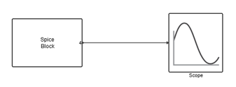

  9. From the Palette Browser, select Activate > SignalViewers.
  10. Drag one Scope block into your diagram and connect it to the output of the SpiceCustomBlock.
    This portion of the model is ready to run and test.

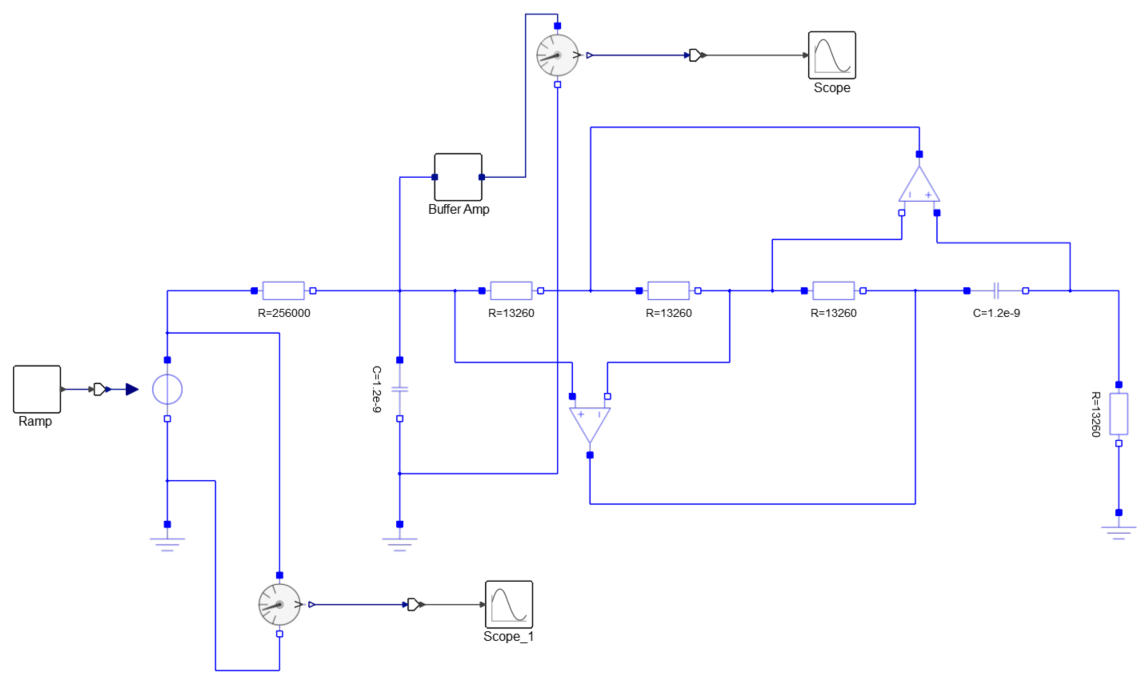

  1. From the Demo Browser, select BandPassFilter.scm
    The BPF model constructed from Modelica blocks appears.

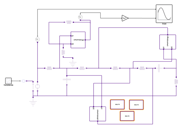

  2. Beginning with the Filter.scm model you started, construct a Spice version of the circuit model using the blocks from the HyperSpice palette.
    To create these components in your model Include these blocks from the HyperSpice palette
    Voltage and current stimulus Voltage Constant; Voltage Pulse; Voltage SIN
    Linear components Resistor; Capacitor; Inductor
    Voltage and current constant sources Include blocks as required for your model.
    Semiconductor components Diode; BJTNPN; BJTPNP; Mos1N; Mos1P; Mos2P; Mos2N; Mos3N; Mos3P
    Sub circuits Include blocks as required for your model.
    Cable or S-parameter functions Include blocks as required for your model.
    Refer to the Extended Definitions to define the blocks.

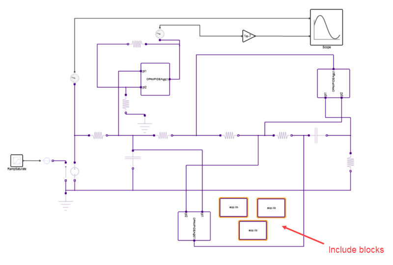

  5. From the Palette Browser > HyperSpice > Analog > Basic, drag one include block into the current diagram, then double-click the block.
    The include block must reside in the diagram, but does not require a connection to the blocks in the diagram.
  6. For File name to include, enter: aop.lib. Keep the defaults for any remaining parameters.
  7. Because three operational amplifiers are required for your model, three include blocks are also required. To duplicate the current include block, select it and press Ctrl+D two times.
    Your final model should look something like this:
