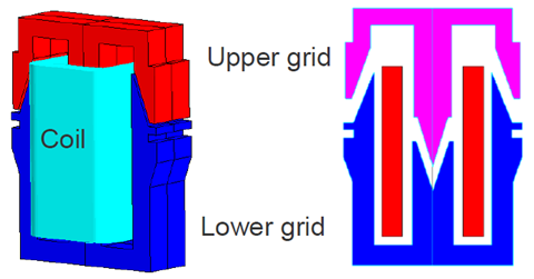

Flux Contactor (Trident) Model
The main Flux contactor model MultiPhysics.FLU is comprised of three main components:
  • A lower grip, ferromagnetic fixed part
  • An upper grip, ferromagnetic (laminated) moving part assembled on springs
  • A coil placed around the central tooth

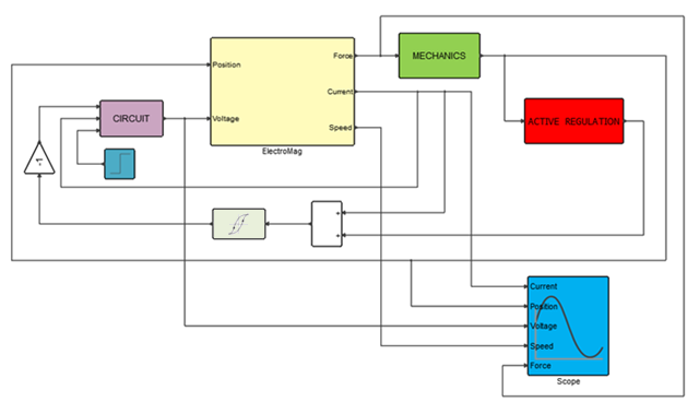

Activate Coupling Model
Figure 1. Actuator_Coupling.scm

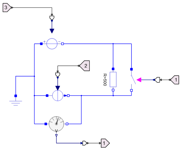

Electric Circuit
The purple CIRCUIT super block in the coupling model is comprised of four main components:
  • a controlled switch that opens and closes based on voltage
  • a resistor that serves to prevent short circuiting
  • a current and voltage input
  • a voltage output sensor

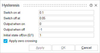

Regulation Command
A simple regulation command in the coupling model is included in the light green Hysteresis block. Here the model is dependent on the active regulation of time.

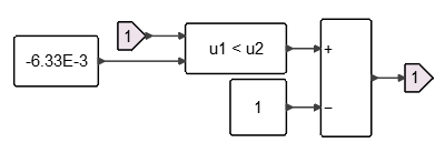

Active Regulation
In the red ACTIVE REGULATION super block, we compare two values and use this to activate the Hysteresis regulation.

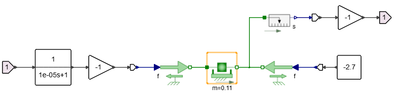

Mechanical Equation
The bright green super block, MECHANICS, includes Modelica blocks to simulate the mechanical part of the device and position the actuator.

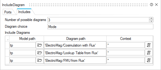

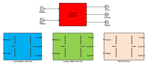

The ElectroMag super block (yellow) of the Activate Coupling model (Actuator_Coupling.scm) contains the electromagnetic component of the model and consists of the Include Diagram block (red) and three additional super blocks: Cosimulation with Flux (blue), Lookup TableND from Flux (green) and FMU from Flux (pink) that you see in the following diagram. The Include Diagram block defines which super block to call into play depending on which simulation method you specify through the Mode variable. The super blocks are inactive otherwise.
Model Variants

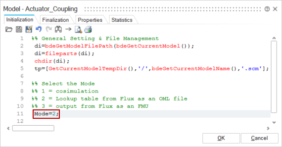

The Activate model Actuator_Coupling.scm is configured to implement three methods of simulating the Flux contactor with and Activate actuator in one model. In practice, to drive the three variants, one variable is defined in the Initialization phase for the model. This variable is named Mode and can be set to 1, 2 or 3.
The Mode variable is used in the IncludeDiagram block to determine which of the three super blocks to include in the simulation.
Inclde Diagram block set defined for Mode 2

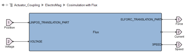

Co-Simulation Method
In Activate, open the model Actuator_Coupling.scm.

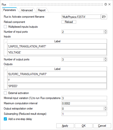

In the super block Cosimulation with Flux, the Flux block performs the co-simulation by reading in the coupling component that was generated using the Flux 2D transient application file MultiPhysics.F2STA.

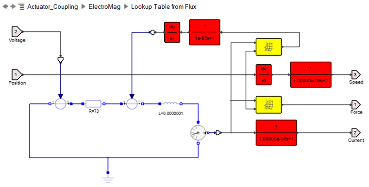

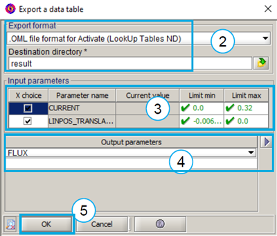

The super block Actuator_Coupling > ElectroMag > Lookup Table from Flux includes a context to read in the results exported from a magnetostatics simulation in Flux.

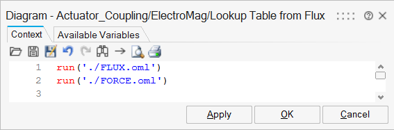

The Flux results are exported as two .oml files FLUX.oml and FORCE.oml. These files are available in the Flux project folder and are directly read in from the Activate model. In the following image, the super block Lookup Table from Flux includes the yellow blocks LookupTableND and LookupTableND_1 which load FLUX.oml and FORCE.oml respectively.
The context of this diagram includes the directions for the FLUX.oml and FORCE.oml files to be read into the super block.

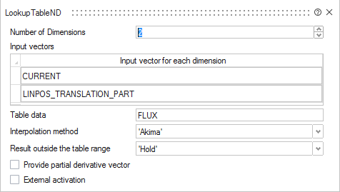

In the Lookup TableND dialog, the field Table data calls the OML variable FLUX from the FLUX.oml file as an interpolated function of the two vectors CURRENT and LINPOS_TRANSLATION_PART.

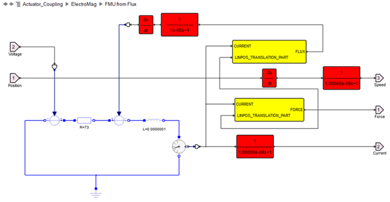

The super block Actuator_Coupling > ElectroMag > FMU from Flux includes a context to read in the results exported from a Flux 2D magnetostatics simulation.

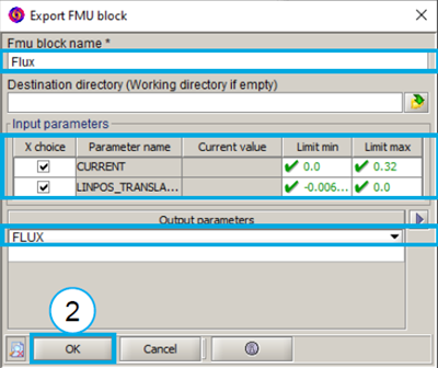

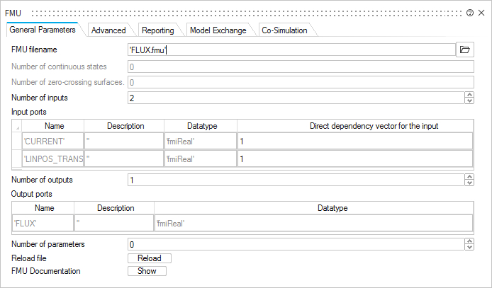

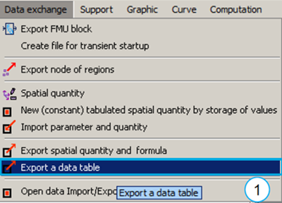

The Flux results are exported as two .fmu files: FLUX.fmu and FORCE.fmu. The steps in Flux to export the .fmu files are indicated in the following dialogs:
The .fmu files are available in the Flux project folder and are directly read in from the Activate model. In the super block FMU from Flux, the yellow blocks are FMU and FMU_1 that load FLUX.oml and FORCE.oml respectively.
The Functional Mockup Interface standard is an important gateway to other products. In this tutorial, the use of either a Lookup Table or an FMU are almost identical and are meant to illustrate various features of Flux and Activate.

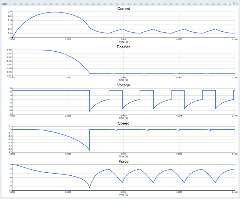

Mode 1: Co-Simulation Method
With the co-simulation method, a Flux transient (dynamic) analysis is run directly from Activate through the coupling component from Flux. This type of simulation is slow but can account for Eddy current effects in massive iron conductors. The added value of the Flux-Activate co-simulation coupling is the accuracy of the results with the inclusion of the Eddy currents. In this case, the type of kinematics in the mechanical rotor is multiphysics position. Note that the value of the initial position must be determined in order to obtain the correct results.
Co-Simulation results with the evolution of current, position, speed and force as a function of time

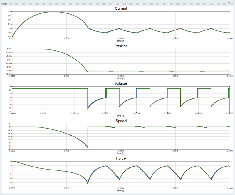

Results Comparison
Aside from the varying peaks between the three methods: co-simulation in blue, OML in red and FMU in turquoise, the results are very similar. The small variance is due to the different interpolation methods applied to run simulations on reduced models for the OML and FMU methods.
Results comparison of the three simulaiton methods
