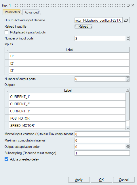

 - Generate the Flux coupling component required for Activate to read in the Flux model data.

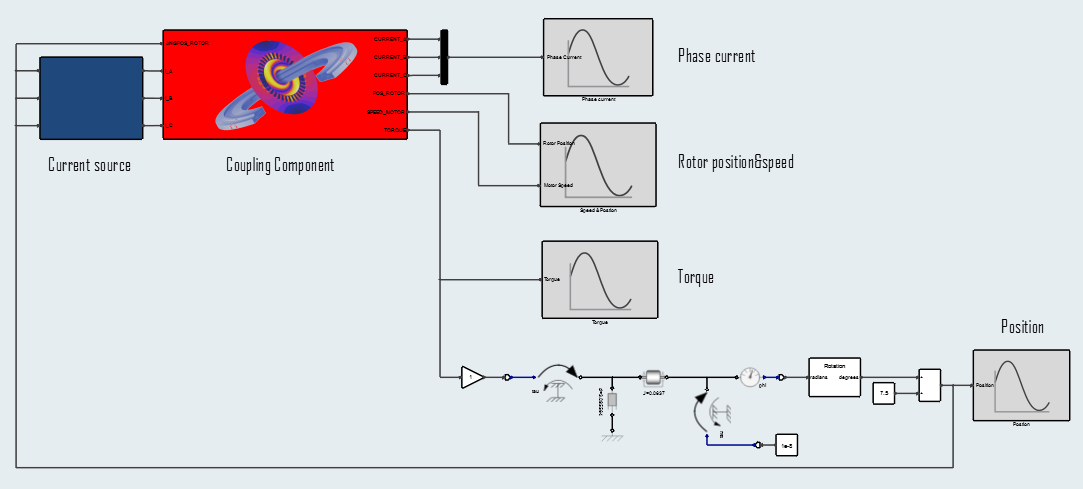

 - Create an Activate model and include the Flux block for reading in the Flux coupling component.
 - Co-simulate the models from Activate.

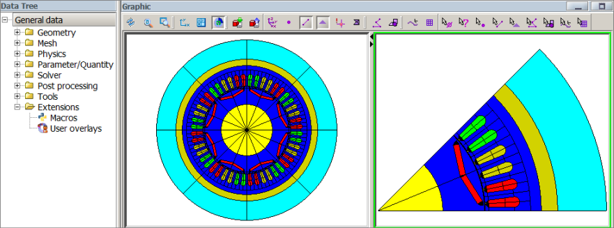

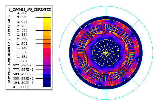

Overview of the Flux IPM Motor
The Flux model is a brushless, AC, Interior Permanent Magnet motor applicable for electric vehicles.
- Fixed part (stator) including yoke, slots, and windings
 - Air gap
 - Moveable rotor with embedded magnets
The IPM motor is driven with a three-phase sine current, running with kinematics type Multiphysics position. The simulated motor performances are applied for computing torque, phase current, speed and rotor position.

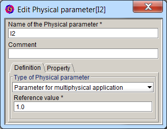

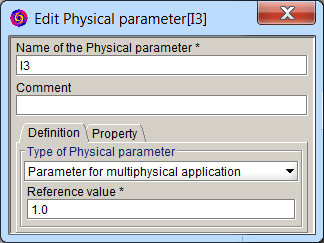

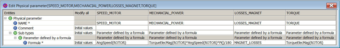

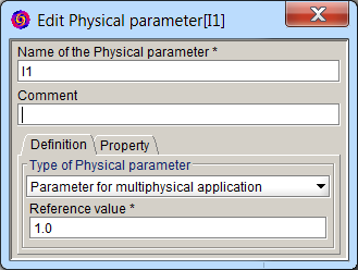

The inputs for the IPM motor are defined as multi-physical parameters and include:
- I_1: Physical quantities: μr, Bs, Br
 - I_2 Electrical quantities: resistance, voltage, current
 - I_3: Mechanical quantities: position, speed, electromagnetic torque

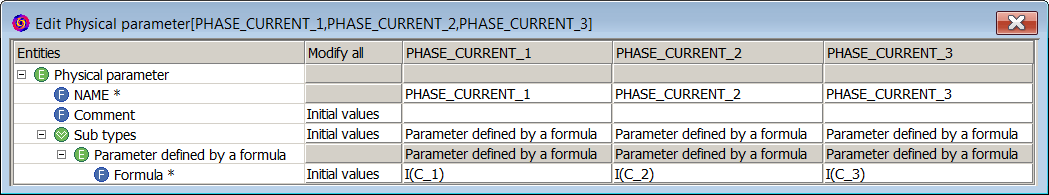

    The outputs for the IPM motor are scalar I/O settings that retrieve values through the sensors, formulas (torque) and parameters (position, speed, acceleration).

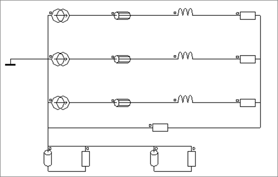

    The circuit of the IPM motor is configured with a current source, coil conductor, resistor and inductance.
      Figure 1. Electrical circuit of IPM motorGenerating the Coupling Component in Flux

Creating the Activate Model

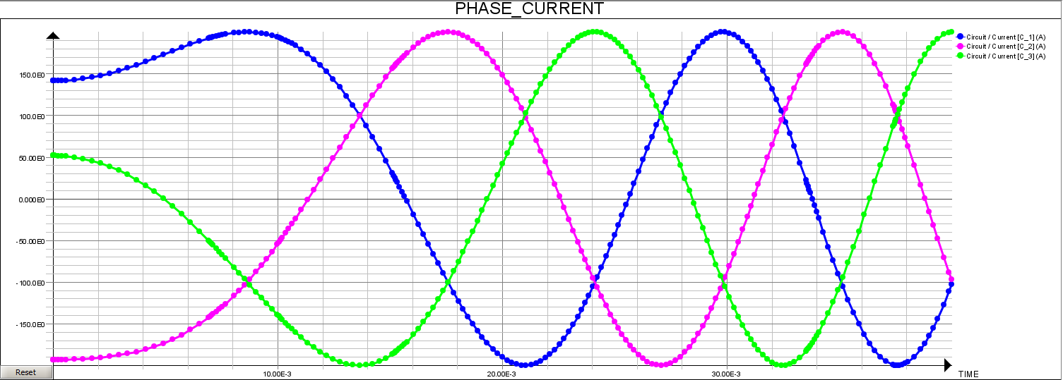

Create a model to feed a three-phase sine current into the Flux model of the IPM motor.

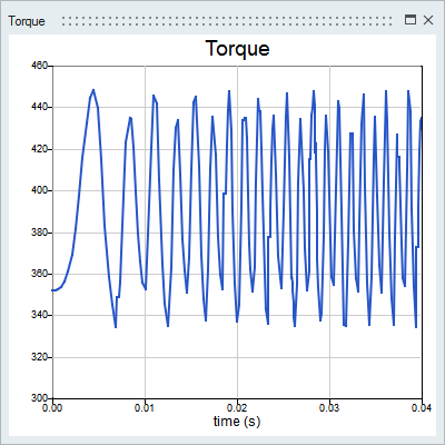

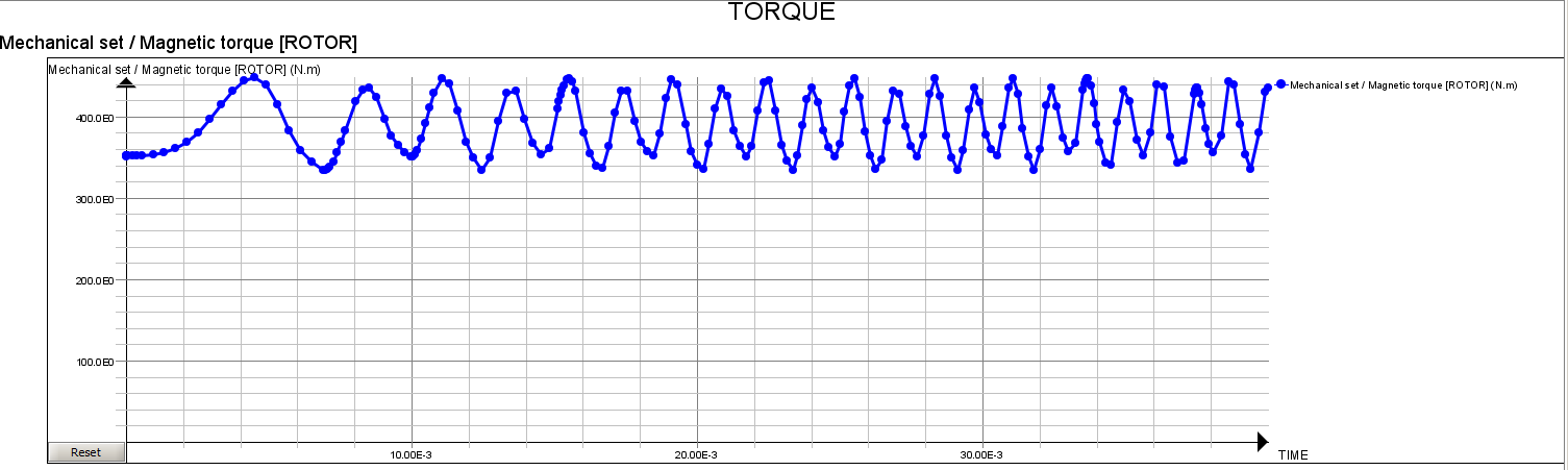

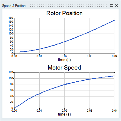

Co-Simulating the Activate and Flux Models

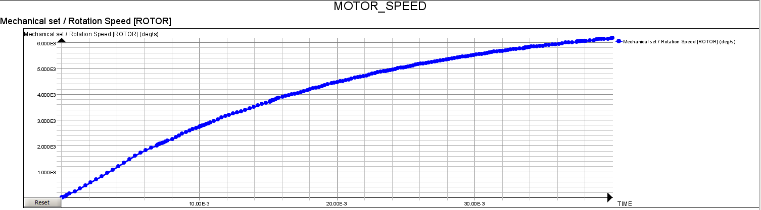

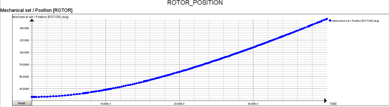

During co-simulation, the Activate model supplies a three-phase sine current into the Flux model of the IPM motor. The simulation results show the performance of the IPM motor including torque and losses at constant speed.
