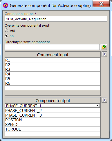

 - Generate the Flux coupling component required for Activate to read in the Flux model data.

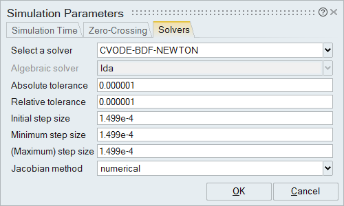

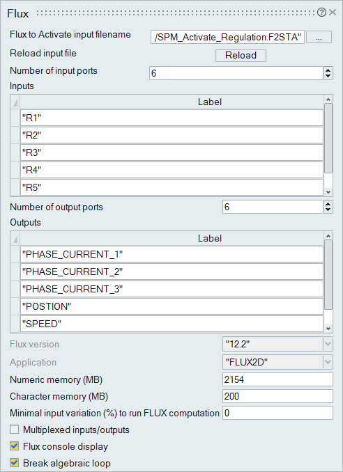

 - Create an Activate model and include the Flux block for reading in the Flux coupling component.
 - Co-simulate the models in Activate.

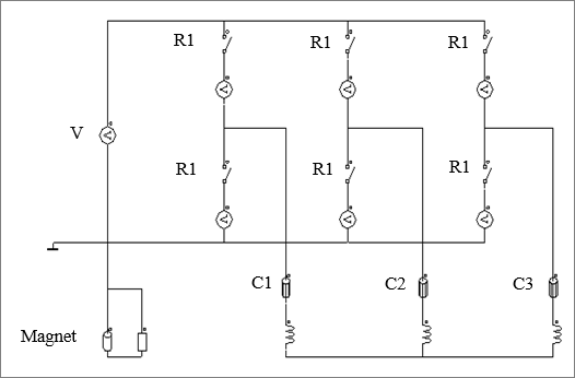

The SPM motor is driven with a three-phase bridge current (the freewheeling diodes are neglected). The constant speed operation of the motor at 1000 rpm with inverter driver is simulated to yield motor torque, speed, position and phase current. The inverter switching scheme is rotor-position dependant.

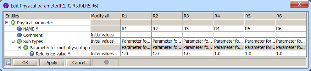

The inputs for the SPM motor are defined as multi-physical parameters and include:
- I1: Physical quantities: μr, Bs, Br
 - I2: Electrical quantities: resistance, voltage, current
 - I3: Mechanical quantities: position, speed, resistant force, resistive torque
  The outputs for the SPM motor are scalar I/O settings that retrieve values through the sensors, formulas (forces and couples) and parameters (position, speed, acceleration).
   Figure 1. Electrical Circuit of the SPM MotorGenerating the Coupling Component in Flux
Load the Flux model and generate the coupling component with the required inputs, outputs and parameters.

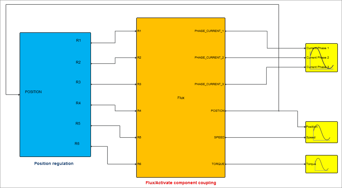

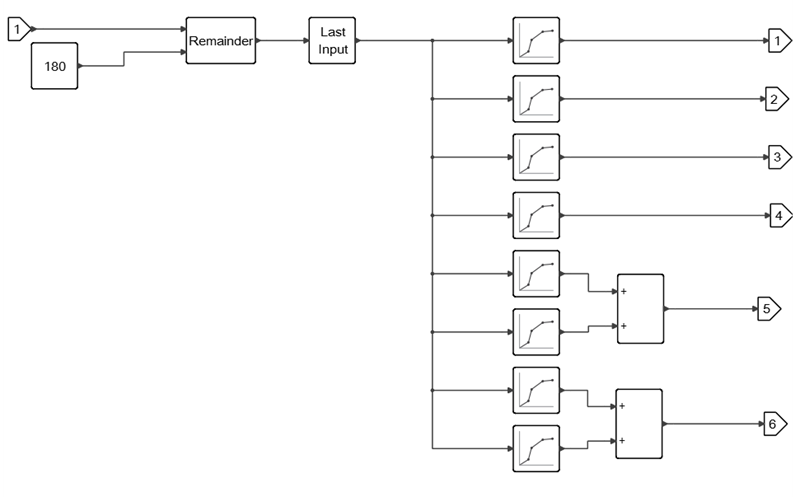

Create a model to feed a three-phase bridge circuit.
Co-Simulating the Activate and Flux Models

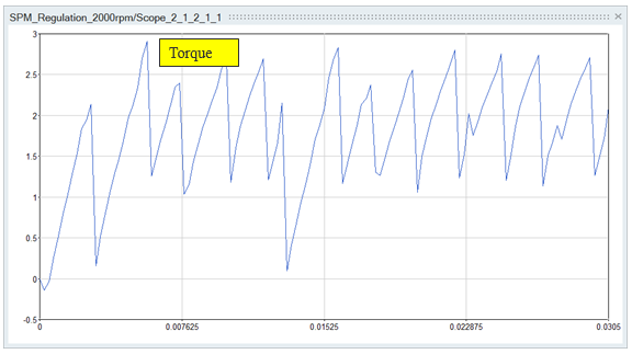

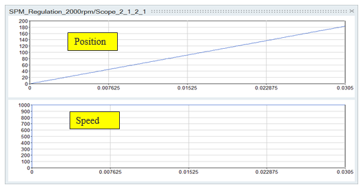

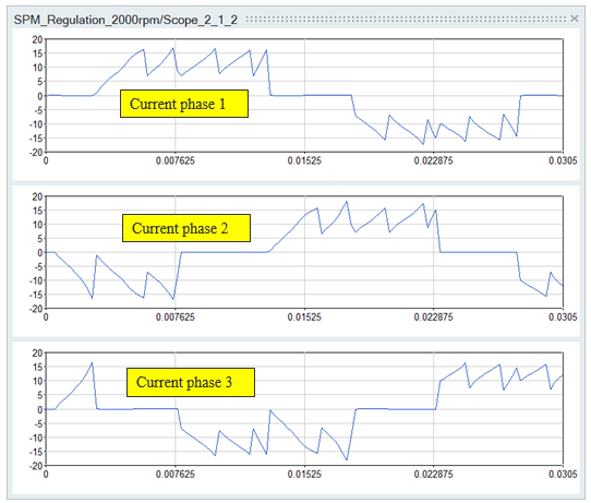

During co-simulation, the Activate model supplies a three-phase bridge current into the Flux model of the SPM motor. The simulation results show the performance of the SPM motor including position, speed and torque.
