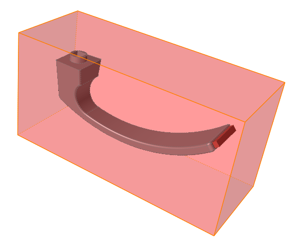

Designate a Cast Part
Create an Ingate
Create a Mold

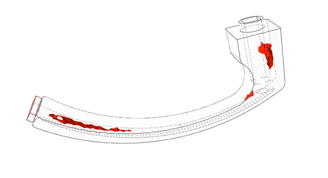

View the Porosity Result
- To avoid defects like trapped air, we can optimize the size, shape, and placement of the inlet. Experiment with the gate's configuration and placement and re-run the analysis to see the difference in the results.

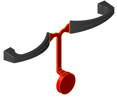

Designate Filling System

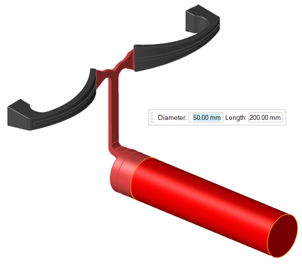

Generate a Shot Sleeve

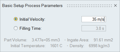

Configure High Pressure Parameters

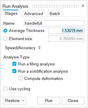

Run Analysis
