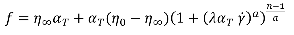

Carreau Yasuda model is expressed by the following equation. This model has five parameters, zero shear viscosity, infinite shear viscosity, time constant, transition parameter, and power law exponent.
This model has a well defined upper (zero shear viscosity) and lower (infinite shear viscosity) limits for the polymer viscosity. Typically, the value of transition parameter is 2. Time constant lambda alters the nonlinear behavior of the fluid and its dependence on the shear rate. If the time constant is 0, then the fluid becomes Newtonian, with a high value for the time constant, eta becomes a strong function of shear rate. By suitable choice of parameters, many other models can be mimicked by this model.
