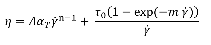

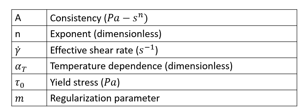

Regularized Herschel-Bulkley model is a four-parameter model and it is given by the following equation.

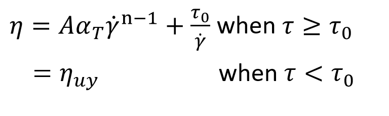

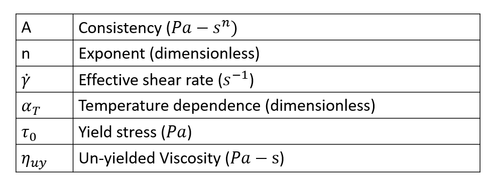

This model describes the viscosity using a power-law relationship and a yield criterion. The exponent n determines the nature of the power law relationship and the yield criterion is implemented using the regularized model with yield stress t0 and regularization parameter m. Higher the value of m, closer the approximation to the actual yield stress behavior of Herschel-Bulkley model. For practical purposes, value of m=10000 should be suffice. This regularization parameter controls the exponential growth of stress. The original Herschel-Bulkley model, which is given by the following equation, suffers from the disadvantage of stress growing very large when the shear rate tends to zero. This will lead to numerical instability and also increase the difficulty of obtaining a converged solution. Hence, this model is regularized using the parameter m.
