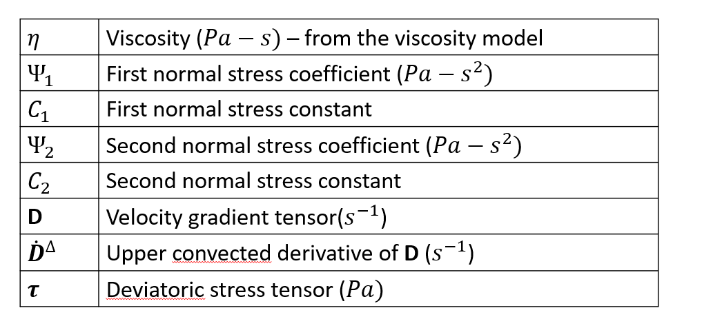

In this model, the deviatoric part of the stress tensor is expressed as function of the viscosity and the normal stress coefficients.
This model can be used with any of the above mentioned non-Newtonian models and the specific model selected is used only to describe the viscosity of the material. The first and second normal stress coefficient functions are described as an exponential function of the computed shear rate. In this specific implementation, the second normal stress coefficient is implemented as a function of the first normal stress coefficient.
