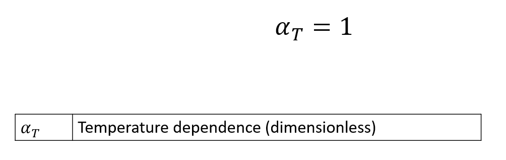

TemperatureDependence="None"
No additional parameters are required for this option. This option implies that viscosity is not a function of temperature and depends only on the shear rate. This option is chosen if the analysis is isothermal or if the variation of viscosity with temperature is negligibly small.
| Parameter | Description | Units | Data Type | Typical Value |
| TemperatureDependence | Specifies one of the five functions available in HyperXtrude for computing temperature dependence of viscosity. | None | String | "None" |

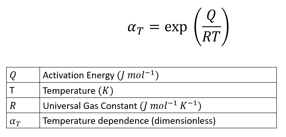

TemperatureDependence="Exp(Q/RT)"
The following equation describes this temperature dependence which is also known as Arrhenius function. R is the universal constant and its value is 8.314 in SI units. The only parameter that needs to be experimentally determined is the activation energy Q. This function is one of the commonly used methods to describe the variation of a property with respect to temperature.
The parameters associated with this function are summarized in the following table.
| TemperatureDependence | Specifies one of the five functions available in HX for computing temperature dependence of viscosity. | None | String | "Exp(Q/RT)" |
| ReferenceTemperature | Temperature at which data is calculated for the initialization step. | K | Constant | 533 |
| FreezeTemperature | This is the no flow temperature. Below this temperature material ceases to flow. | K | Constant | 350 |
| ActivationEnergy | Experimentally determined parameter to define the temperature sensitivity. | J/mol | Constant | 16628 |
| UniversalGasConstant | A parameter from state equation PV = nRT, R is universal Gas constant. | J/mol/K | Constant | 8.314 |

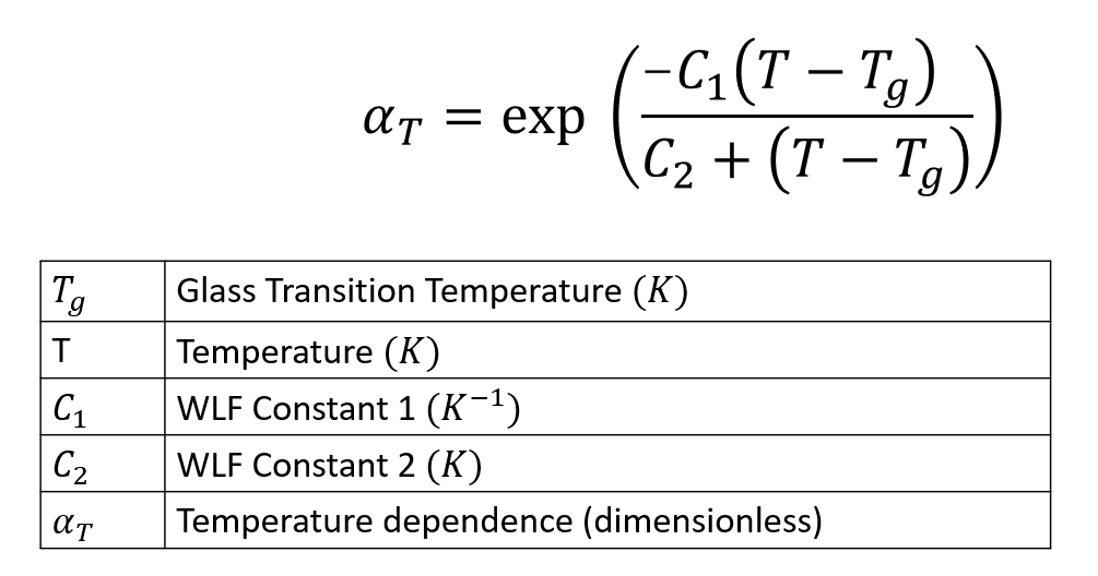

TemperatureDependence="WLF"
The William-Landel-Ferry (WLF) equation is often used with semi-crystalline polymers. This function describes the variation in the property with respect to the data at the glass transition temperature (Tg). It is important to note that C1 is a constant and has no units. The parameter C2 is like temperature difference (deltaT) and its value is same in K and deg C.
| TemperatureDependence | Specifies one of the five functions available in HX for computing temperature dependence of viscosity. | None | String | "WLF" |
| WLFConstant1 | Constant C1 of WLF model | None | Constant | 17.44 |
| UWLFConstant2 | Constant C2 of WLF model. This is like DeltaT, hence the value is same in K and Celsius. | K | Constant | 51.6 |
| GlassTransitionTemperature | Temperature below with polymer molecules ceases to move (frozen). There are few definitions of this term. | K | Constant | 320 |

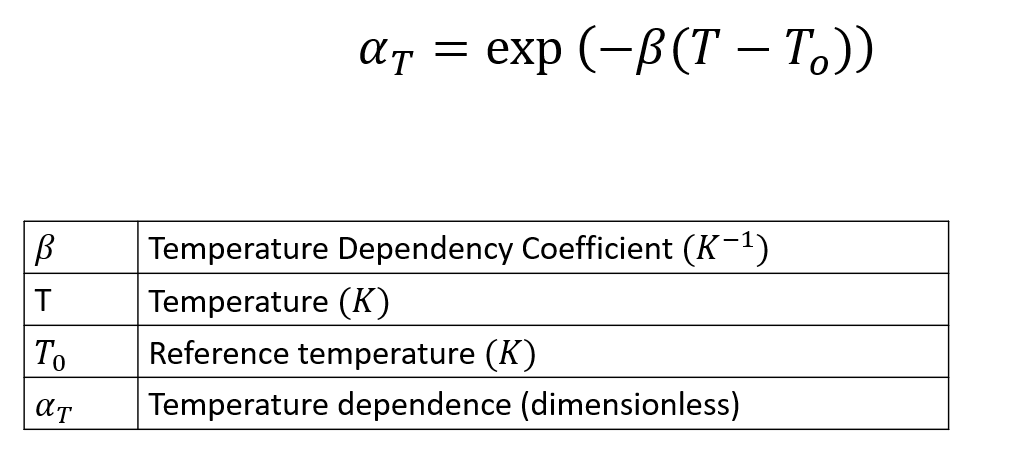

TemperatureDependence="Exp(-Beta(DeltaT))"
This function is mostly used in academic examples and is not as popular as the Arrhenius and the WLF functions. Variation in the viscosity is expressed with reference to the ReferenceTemperature T_0. The parameter beta is experimentally determined.
| TemperatureDependence | Specifies one of the five functions available in HX for computing temperature dependence of viscosity. | None | String | "Exp(Tb/T)" |
| Beta | Parameter in the relationship Exp(-Beta(DeltaT)) | None | Constant | 0.005 |
