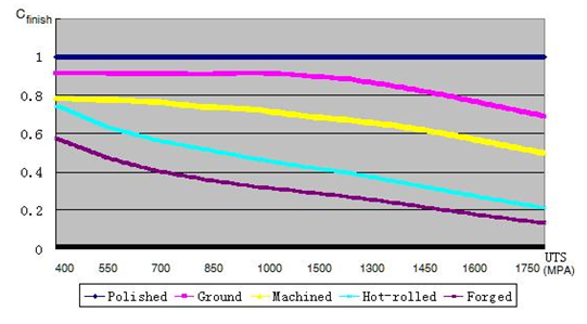

Surface finish correction factor Cfinish is used to
characterize the roughness of the surface. It's presented on
diagrams that categorize finish by means of qualitative terms such
as polished, machined or forged. Figure 1. Surface finish correction factor for steels*
(*Source: Yung-Li Lee, Jwo. Pan, Richard B. Hathaway and Mark
E. Barekey. Fatigue testing and analysis: Theory and practice,
Elsevier, 2005)
