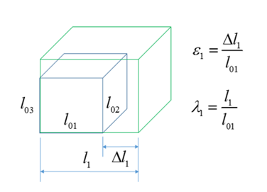

Stretch (also called stretch ratio) is the ratio of final length and initial length. It is used
for materials with large deformations. For a cube in tension:
Engineering strain (also called nominal strain) in
direction 1
Stretch in direction 1
Thus, strain and stretch are related as:(1)

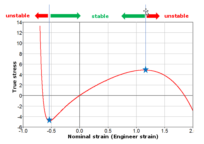

Parameters and must be chosen so that initial shear modulus
is:(6)
For material stability, it is required that each material constant pair
(7)
In general, the Ogden model can be used for strains up to 700%. The number of terms

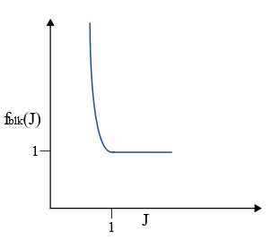

The bulk modulus () of hyperelastic materials is generally a very high
value which provides the needed pressure-resistance to maintain the
incompressibility condition ( =1). But if a material starts to compress ( < 1) then the bulk modulus can be increased by
including the fct_IDblk input
function which allows the scaling of the bulk coefficient value as a function of . By default, there is no scaling and; thus, if the
function identifier is zero and the value of the bulk scaling function is equal to
1. It is advisable to output (/ANIM/BRICK/DENS) and review the
material density of LAW42 components to make sure that the density variation is
small, that is the value of is close to 1 and the material is
incompressible.

The Bulk Modulus is calculated as based on these rules:
If , should be entered.
If , input is ignored and will be recalculated
and output in the Starter output using:(28)
If and =0, a default value of is used and is calculated using Equation 28

Drücker Condition Stability Check
In LAW42 and LAW69, the Drücker stability is automatically calculated by the Radioss Starter.
The Drücker stability condition checks if the change in the Kirchhoff stress
corresponding to the infinitesimal change in the logarithmic strain (true strain)
satisfies the following inequality.(29)
Where, =1,2,3 principal direction.
With the change in logarithmic strain(30)
The change of Kirchhoff stress
Relationship between Kirchhoff stress and logarithmic strain
The Drücker stability condition will be:(31)
Here is tangential material stiffness matrix and it is
also the slope of stress-strain curve:(32)
For a stable material, it requests tangential material stiffness be positive (slope of stress-strain curve is
positive). The tangential material matrix is positive if following conditions
satisfied:(33)(34)(35)
The Kirchhoff stress for Ogden model is:(36)
Since , then for a given Ogden parameter with conditions , the strain range of material in Drücker stability
could then be calculated.
The Drücker stability criterion calculates the strain range where the material model
will remain stable given a set of material parameters. This stability check cannot
be made for every deformation but instead is commonly used to check material
stability under uniaxial, biaxial and planar strain loading.
For example, using the following Ogden parameters:
Then the Drücker stability will be automatically checked in Radioss Starter, and results printed in Starter output file
*0.out. This shows the strain at which instability can
occur for the given Ogden
parameters:
CHECK THE DRUCKER PRAGER STABILITY CONDITIONS
MATERIAL LAW = OGDEN (LAW42)
MATERIAL NUMBER = 1
TEST TYPE = UNIXIAL
COMPRESSION: UNSTABLE AT A NOMINAL STRAIN LESS THAN -0.3880000000000
TENSION: UNSTABLE AT A NOMINAL STRAIN LARGER THAN 0.9709999999999
TEST TYPE = BIAXIAL
COMPRESSION: UNSTABLE AT A NOMINAL STRAIN LESS THAN -0.2880000000000
TENSION: UNSTABLE AT A NOMINAL STRAIN LARGER THAN 0.2780000000000
TEST TYPE = PLANAR (SHEAR)
COMPRESSION: UNSTABLE AT A NOMINAL STRAIN LESS THAN -0.3680000000000
TENSION: UNSTABLE AT A NOMINAL STRAIN LARGER THAN 0.5829999999999
Note: For a Neo-Hookean material with (or ), the material is always stable and thus no
critical value is found by the Drücker stability check.
For a Mooney-Rivlin material, the Drücker stability should be checked since could be negative, which leads material
instability.

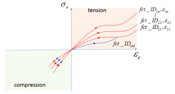

Unloading Behavior
Unloading can be represented using an unloading function or by providing hysteresis
and shape factor inputs to a damage model based on energy.
If using the damage model, the loading curves are used for both loading and unloading
and the unloading stress tensor is reduced by:(38)
with(39)
Where,
Current energy
Maximum energy corresponding to the quasi-static behavior
and
Input by user

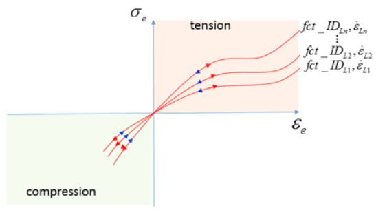

If an unloading curve is provided, these options are available:
Tension
Loading and Unloading
= 0
Loading use loading function
fct_IDLi and
Unloading use unloading function
fct_IDunL
= 1
Loading and unloading all use loading function
fct_IDLi and
= -1
fct_IDLi and
Tension
fct_IDunL
Compression
Unloading use loading
fct_IDLi
and
