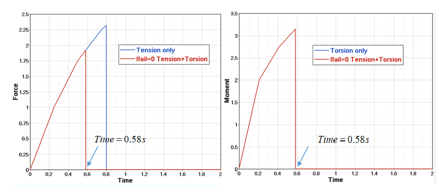

If a spring is subject to two load cases, for example,
tension and torsion and Ifail = 0 (uni-directional failure) is in use, then spring failure occurs
if either one of the failure criteria is reached.
Here the rotation criteria is reached first (at Time=0.58s), then the force and moment fall to
zero at the same time.

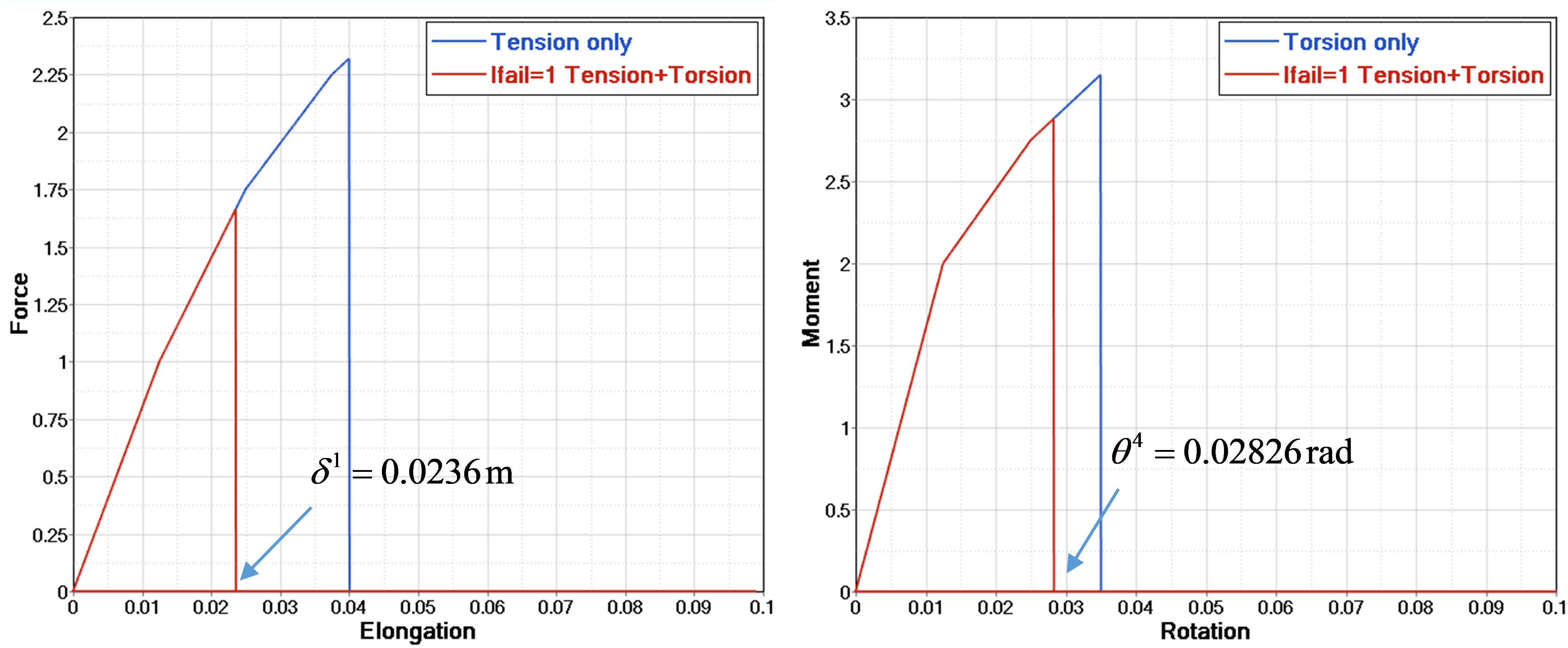

In a test case of two load cases, tension + torsion and
with Ifail = 1.

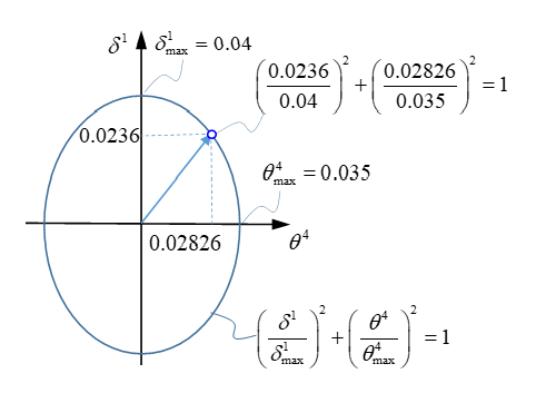

Comparing the failure value against the limit set in just
one direction, it usually is smaller than the defined limit. In this
example case, the tension limit is set at 0.04m and torsion limit set at
0.035rad. The spring fails at an elongation 0.0236 < 0.04 and
rotation 0.02826 < 0.035. This is because the failure combination of
tension and torsion reaches the failure circle (Figure 6) and; therefore, the
spring failed (force and moment fall to zero).

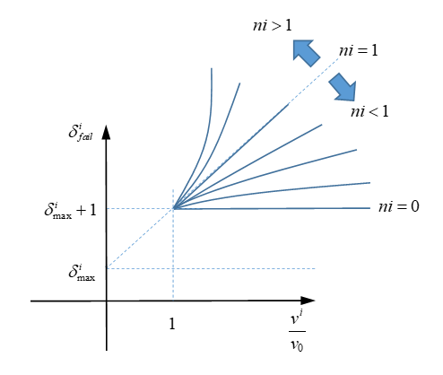

This
failure criteria will allow model velocity dependent failure limits,
they are available with displacement, force and internal energy.
Therefore, translational and rotational failure are modified to take into
account velocity, as:(3)
and
The parameter is a scale of exponent function, and
parameter effects the failure as in Figure 7.
The above formulas’ are valid for displacement/rotation
criteria and are also force/moment and energy criteria.
