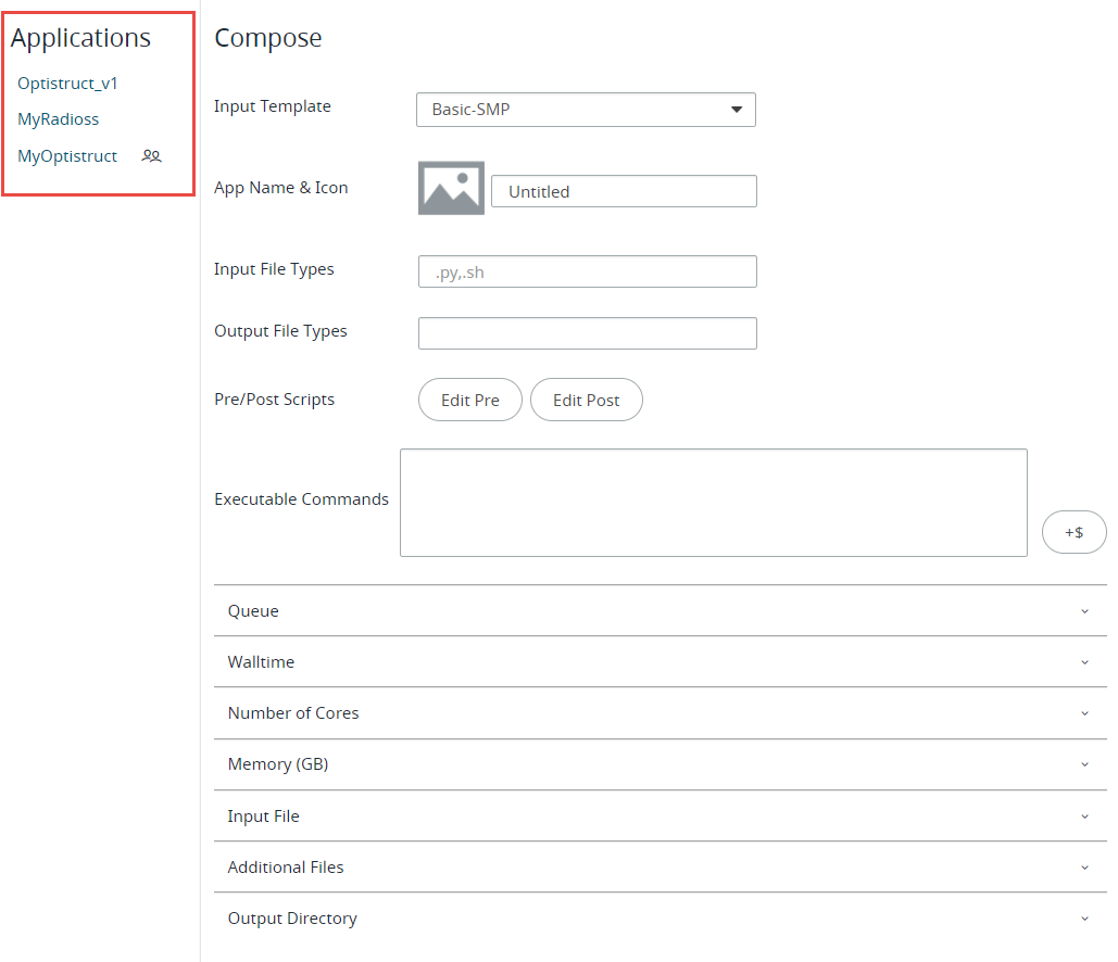

    The Applications panel lists all the application definitions that is created, shared and published.
    Figure: App Composer
    The indicates that it is a shared application definition.
    Note: Delete is the only option that will be available till you save the application definition locally.

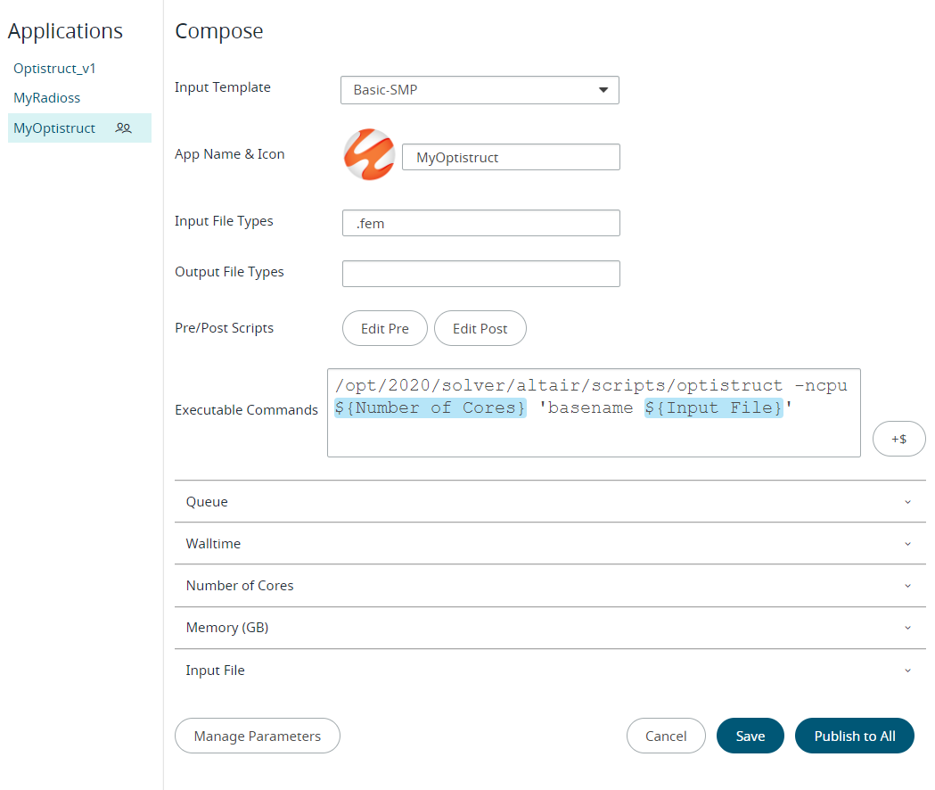

  4. Click the application definition to save it as a local copy.
    The application definition parameters are displayed in the Compose panel.
    Figure: Application Definition Published
    Review the application definition and edit the application definition if required before publishing the application definition to all the users.
  5. Click Publish to All.

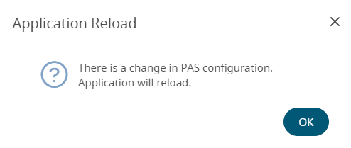

    The application definition will be published to all the users making it a global application definition and a notification will be displayed.
    Access Web will get a notification that application defintion has been updated.

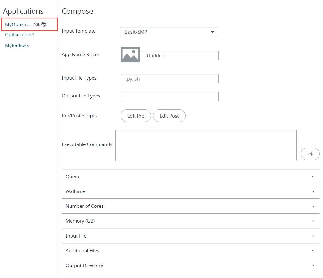

    The application definition that is published will get updated in the application list with icon.
    Figure: Global Application Definition
    Note: The administrator cannot edit, update or view the application definition after publishing it to all the users.
