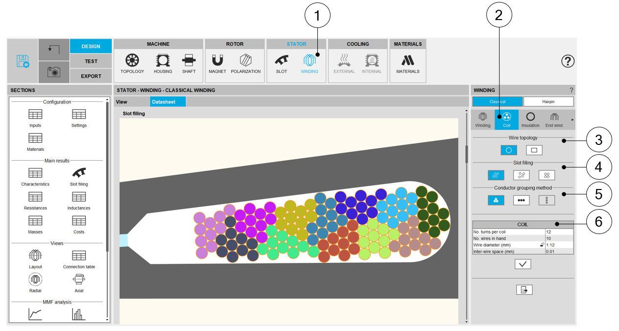

| 1 | Selection of the STATOR subset: WINDING panel (Click on the icon WINDING) |
| 2 | Coil settings allows the user to describe the coil composition (turns, wires, dimensions) and how to fill the slot. |
| 3 | Definition of the wire topology, Circular or Rectangular |
| 4 | Choice of the method to fill the slot: Three ways are allowed to fill the slot: Orthocyclic, Random, Layer. See below illustrations. |
| 5 | Choice of the method to group the elementary wires. Three ways allow to fill the slot: Grouped, Horizontal, Vertical. See below illustrations. |
| 6 | Description of the coil (turns, wires in hand) and dimensions of elementary wires |

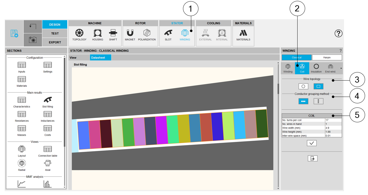

| 4 | Choice of the method to group the elementary wires. Three ways allow to fill the slot: Horizontal, Vertical. See below illustrations. |
| 5 | Description of the coil (turns, wires in hand) and dimensions of elementary wires |

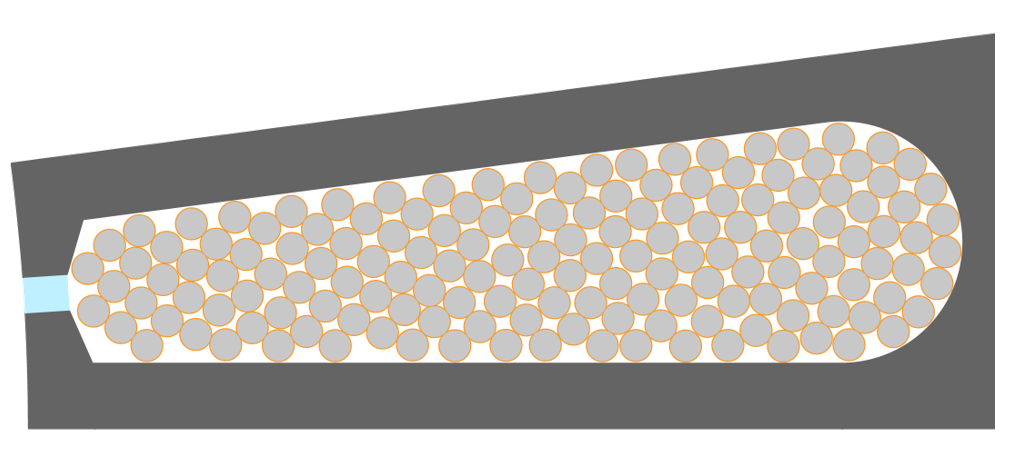

| Slot filling | * | Three ways are allowed to fill the slot: Orthocyclic, Random,
Layer See below illustrations |

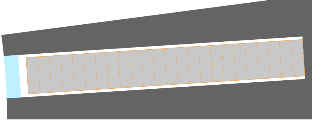

| Conductor grouping method | * | Three ways are allowed to fill the slot: Grouped, Horizontal,
Vertical See below illustrations |

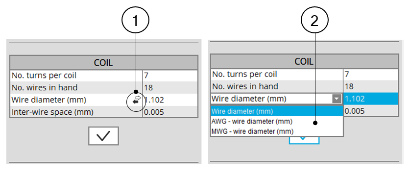

1) Different ways are available to choose the wire diameter:
- Directly entering the value of the wire diameter (without insulation)
- Choose the diameter from the American Wire Gauge table in which available wire diameters are listed (without insulation)
- Choose the diameter from the Metric Wire Gauge table in which available wire diameters are listed (without insulation)
| 1 | Multiple choices with a scrolling selection bar for selecting the wire diameter |
| 2 | Three ways are available for defining the dimensions of the wire
diameter:

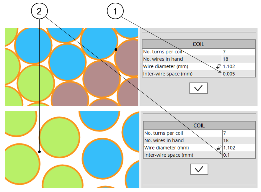

2) Illustration of inter-wire space
This value is considered in Motor factory for computing the filling factor, and also while exporting a model into Flux environment (EXPORT area) for building the corresponding finite element model.
| Illustration of inter-wire space | |
| 1 | Default value for inter-wire space and the corresponding pictorial display. |
| 2 | Impact of a higher value for inter-wire space |

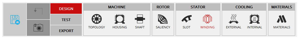

Motor Factory Design environment icon and winding icon in the Stator section are colored in red. This means that a design fault exists, and must be corrected in the winding section of the design environment.
| Motor Factory Design environment Icon and the winding icon in the Stator section are colored in red.= a design fault must be corrected |
