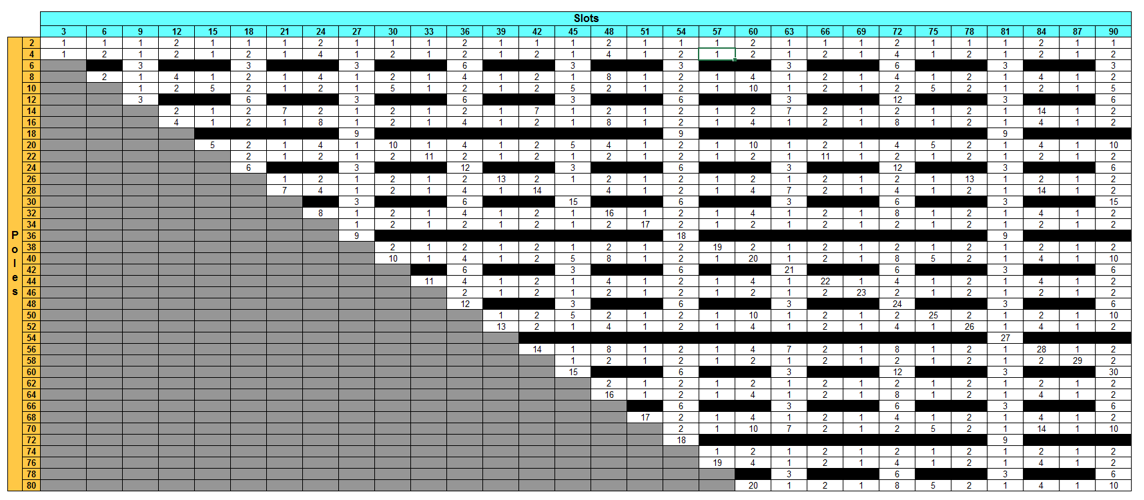

A table representing a selection of combinations of number of poles and number of slots is presented below.
In this table the number of slots goes from 3 to 90 and the number of poles goes from 2 to 80.
- The grey cells correspond to combinations with a number of slots per pole per phase strictly lower than 0.25. These cases are not allowed by our process.
- The black cells correspond to forbidden combinations from a technological point of view.
- The numbers indicated in the other cells correspond to reduction coefficients to
the resulting model in Altair Flux TM .
For example, “1” means that the whole geometry is represented. “2” means that only half of the machine is represented, and “n” means that the n th of the geometry is represented in the Flux®
That also gives a general idea of the size of the model in Flux® software. Higher value gives the reduction coefficient and faster computation for a given motor.
| Combinations No. poles / No. slots |
