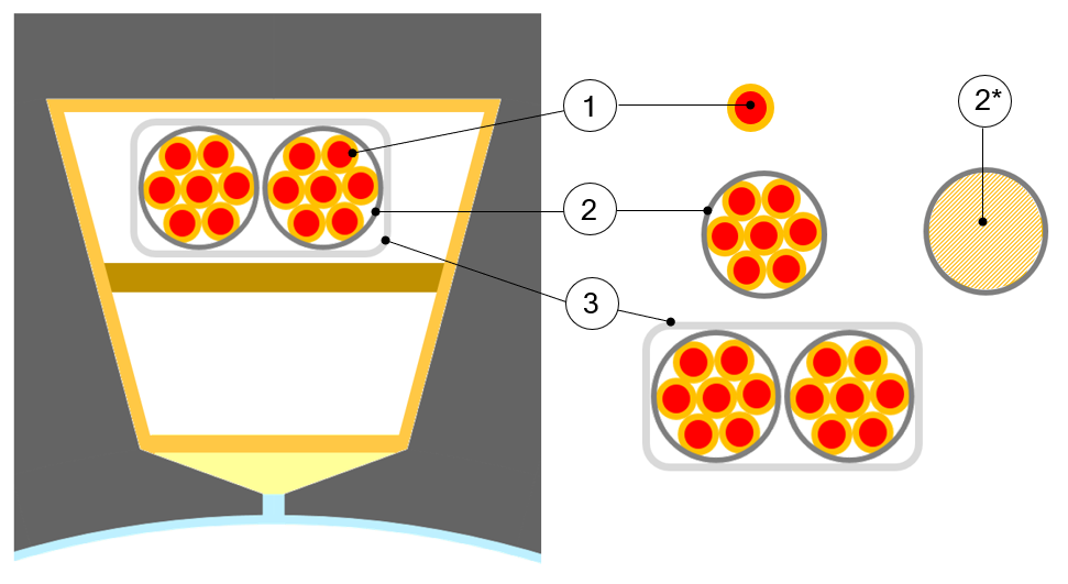

2. Definition – illustration
Slot composition
1 Wire also called strand.
2 Conductor. That also corresponds to a turn section (one conductor = one turn).
A conductor is composed with one or several wires in parallel.
2* The hatched area corresponds to the conductor’s useful area. Area which includes: the wires + insulation + free space. This is not the conductive area.
3 Coil which is an assembly of several conductors (i.e. several turns per coil).

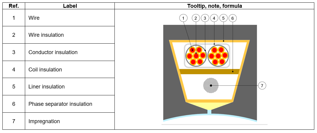

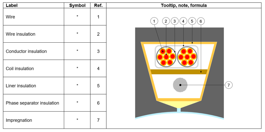

5. Setting – Coil Insulation thickness
For more details see section “Choice of winding MATERIALS”. All the thicknesses are defined as user input parameters in winding – Settings – Coil tab.
Label Symbol Tooltip, note, formula
Wire * Insulation thickness of the wire
Conductor * Insulation thickness of the conductor
Coil * Insulation thickness of the coil
Liner * Insulation thickness of the liner
Phase separator * Insulation thickness of the phase separator
Impregnation * Insulation spread inside the slot
Impregnation goodness * Quality of impregnation (percentage of winding impregnation)
