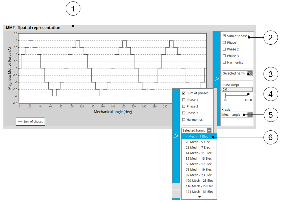

| WINDING design area | |
| 1 | Select the spatial displaying of the Magneto-Motive Force (M.M.F.) |
| 2 | Check the curves to display. Sum of phases M.M.F or M.M.F. provided by
each phase. Note: Superimposition of harmonics is
possible only if one or several harmonics have been selected before. See
explanation below.
| 3 | Visualize the harmonic list of the M.M.F. |
| 4 | Select the phase to make slide the M.M.F. signal. That shows the direction of rotation of the M.M.F... This illustrates the relevance of the phase sequence (user input). |
| 5 | Mechanical angle or slot number can be chosen for the X-axis. |
| 6 | Select one or several harmonics to superimpose with the M.M.F. original signal. |

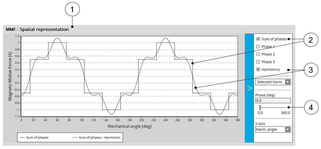

| Superimposition of harmonics to M.M.F. original signal | |
| 1 | Select the spatial representation of the Magneto-Motive Force (M.M.F.). |
| 2 | Check the curves to display. Sum of phases for example. |
| 3 | Check Harmonics. The harmonics previously selected in the M.M.F. harmonic table are superimposed with the original M.M.F. signal. |
| 4 | The selected phase is equal to 0. |
