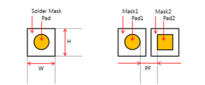

    • Board Figure Geometries: Set the size of the target objects. Use if the fiducial mark is defined with a solder-mask and/or pad.
      • Mask1(S/R) Size (SS): Set the fiducial mark with the outer mask’s size.
      • PAD1 Size (PS): Set the fiducial mark with the inner pad’s size.
      • Mask2(S/R) Size (SS): Set the fiducial mark with the outer mask’s size.
      • PAD2 Size (SS): Set the fiducial mark with the inner pad’s size.
      • Mask/PAD Distance (PF): Set the fiducial mark with the distance between the pads.

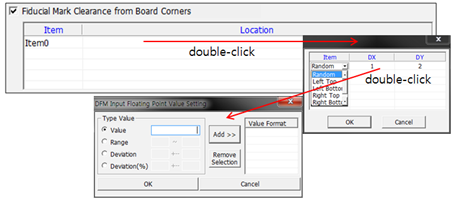

    • Fiducial Mark Clearance from Board Corners: Verify that the fiducial marks are placed in the proper position. Define a suitable area for placement from the board edge corners.
      Figure 3.
      Set the fiducial mark’s clearance value from each of the board outline’s corners using the Floating Value Range Input tool.

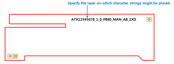

  • Fiducial Mark Existence Checking using Revision Number: Use the revision number on the design to denote the location of the fiducial mark. Define them using several settings. Three rules can be used:
    • Verify that a specified character string is on a specified layer.
    • Verify that the revision name is matching with the given character string and the design file’s name.
    • Verify the locations of fiducial marks using the revision number.
      Figure 5.
    • Layer Selection: Define the layer from the artwork layer list, then use PollEx DFM to verify that it contains character string data.

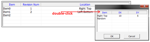

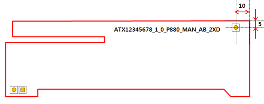

    • Revision Index Table: Use this table to define the fiducial mark’s location depending on the revision number.
      Figure 7.
      If the revision number is 1 in the table, the fiducial mark should be on location 10 and 5 apart from the board's right top corner.
