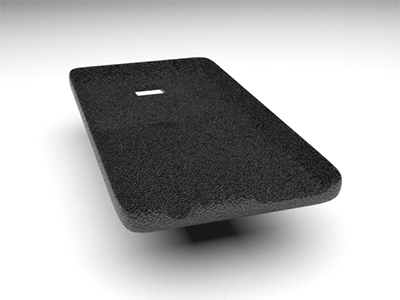

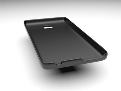

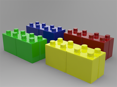

                                    ![]() Figure 1. Plastic without a Coating  |

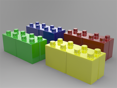

                                    Figure 2. Plastic with a Coating |

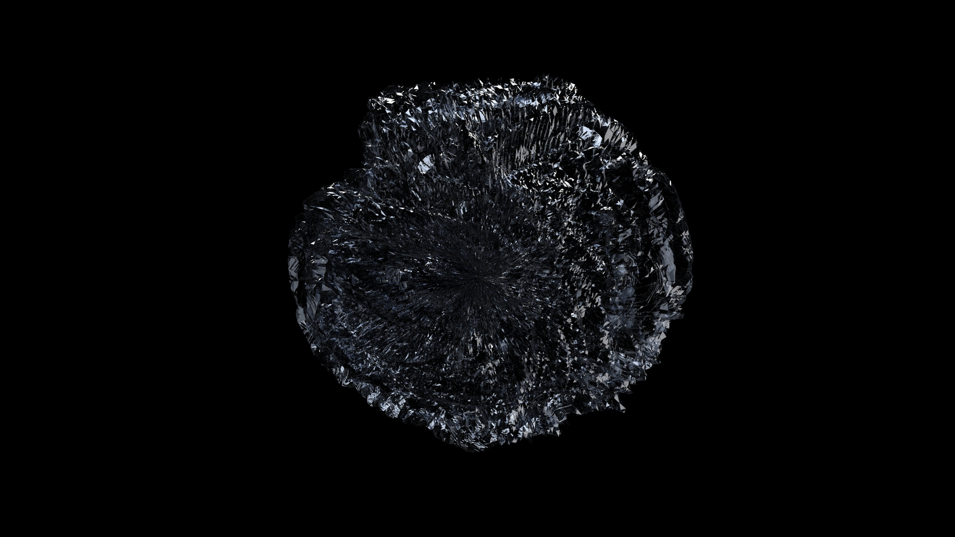

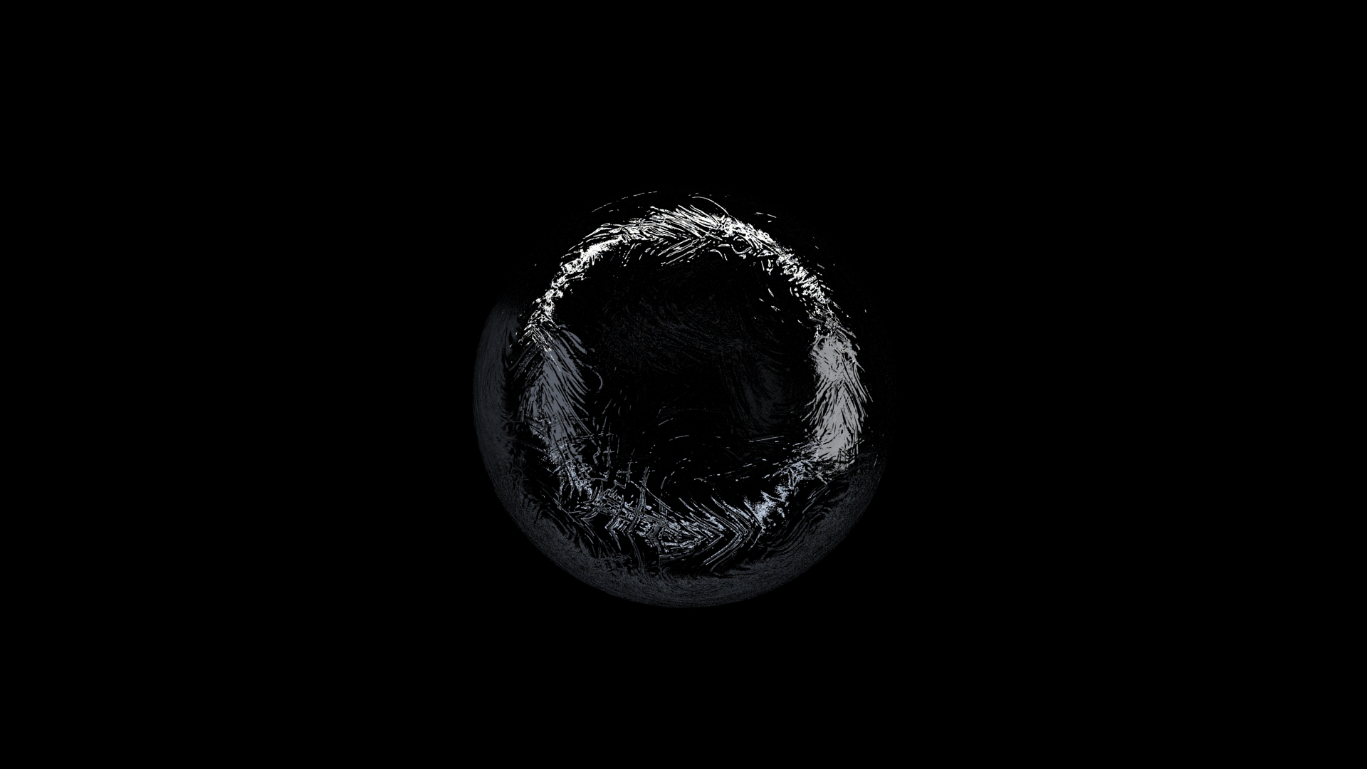

                                                  Figure 6. Subdivision: 2
                                                  Figure 7. Subdivisions: 6Texture: Upload a texture map. Colored images will be mapped as grayscale.

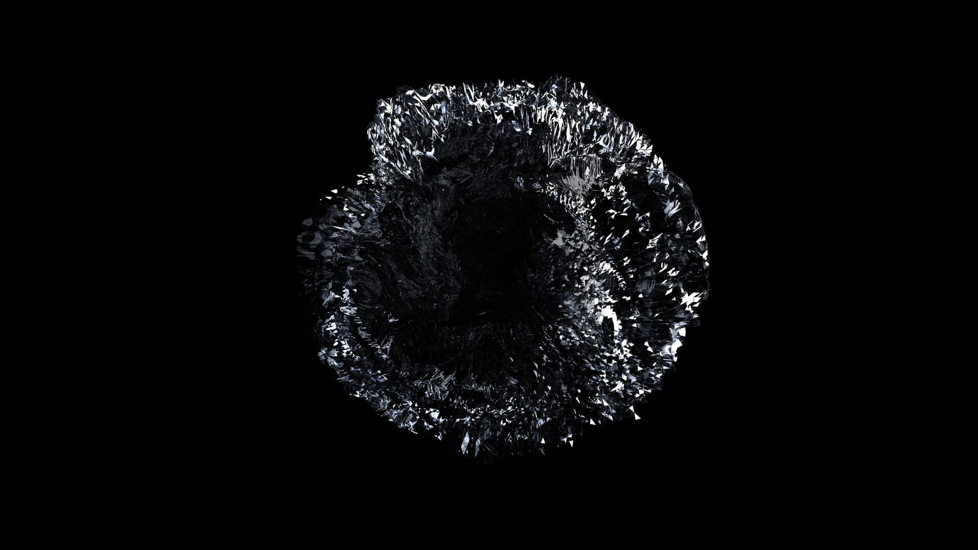

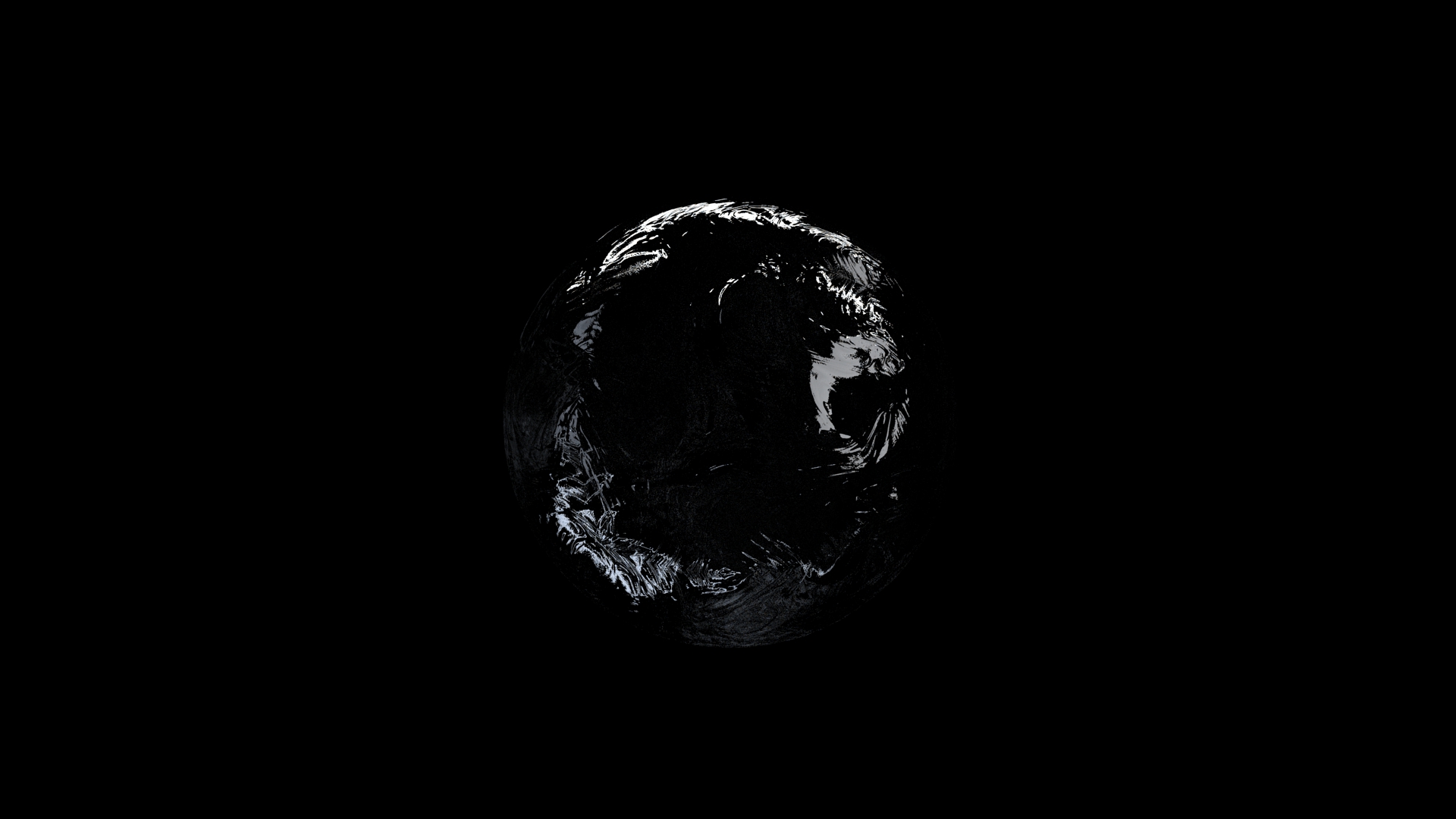

                                                  Figure 11. Center: 0.1cmNormal Smoothing: Enabled by default, to render smoothly (continuous shading). Disable to render in a faceted way, which is useful for rendering very sharp, detailed displacements such as sharp corners.
                                                  Figure 12. Normal Smoothing Disabled
