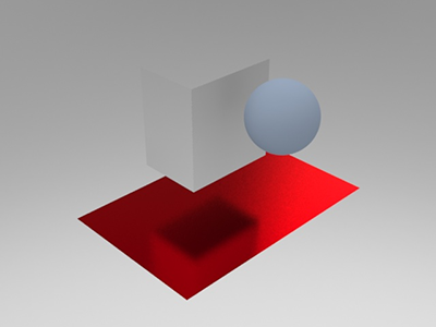

The cube is the shadow catcher object in this scene. As you can see, it casts and receives shadows. It also casts reflections, but does not receive them. A red anodized metal was applied to the plane, while no material has been applied to the sphere.
