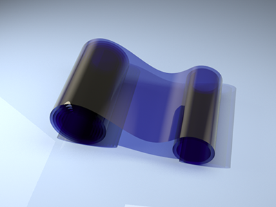

- Thin Film: Create a hollow object with an extremely thin, transparent surface like a thin glass or a soap bubble. Thin film allows light to pass through without bending or scattering, so you can achieve perfect reflection and transparency. You can also produce an iridescent effect.

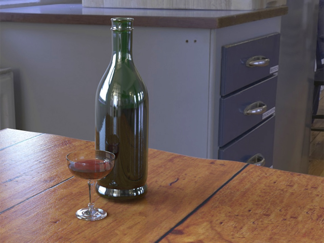

 - Glass
 - Plastic
 - Polycarbonate
 - Water
 - Various minerals including precious and semi-precious gems.
Figure 2. Example of Thin Film
Figure 3. Example of Glass - Reflectivity

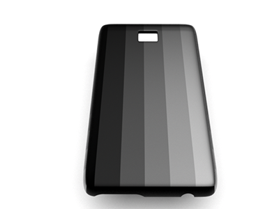

 - Reflectivity maps are based on black and white values, where white
                            equals perfectly reflective and black equals perfectly matte.To define the reflectivity map, choose one of the following options:
- Select a color, which will be mapped as grayscale.
 - Select an image. Colored images will be mapped as grayscale. The image overrides the color. To blend the color with the image, click the plus symbol (+). You can tell if the blend option is turned on by looking at the image preview.
 - To define the strength of the reflections, enter a value of 0-100, where 100 produces perfect mirror reflections and 0 produces the weakest reflections.
Figure 4. Satin Black Plastic with the Image Gray_Scale.jpg (Contrast 50), White (Default Color), and Reflectance 50%

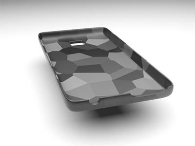

Figure 5. Satin Black Plastic Blended with the Image Noise09.jpg (Molds Folder) - Reflectivity Boost
 - Enhance the reflectivity.
