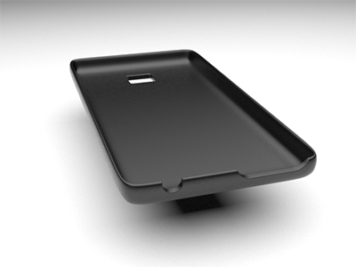

Figure 1. Satin Black Plastic from the Material Library - Presets
 - The Preset is automatically set to
                                Custom.Choose one of the following options:

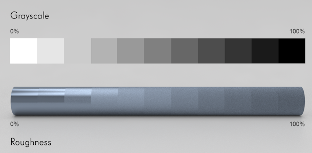

 - Roughness
 - Roughness adds texture to the material at a microscopic level. When you
                            modify the roughness, the surface texture still looks the same; however,
                            tiny changes invisible to the naked eye have occurred, affecting
                                reflectivity.
To add a roughness map, upload an image.
0 can produce a perfect mirror reflection.
Lower values produce crisper and brighter reflections.
Higher values produce blurrier, dimmer reflections. Increasing the roughness spreads and distributes reflections over the surface and creates a more matte surface.
At values approaching 100, light becomes so scattered that reflections are barely visible, if at all.

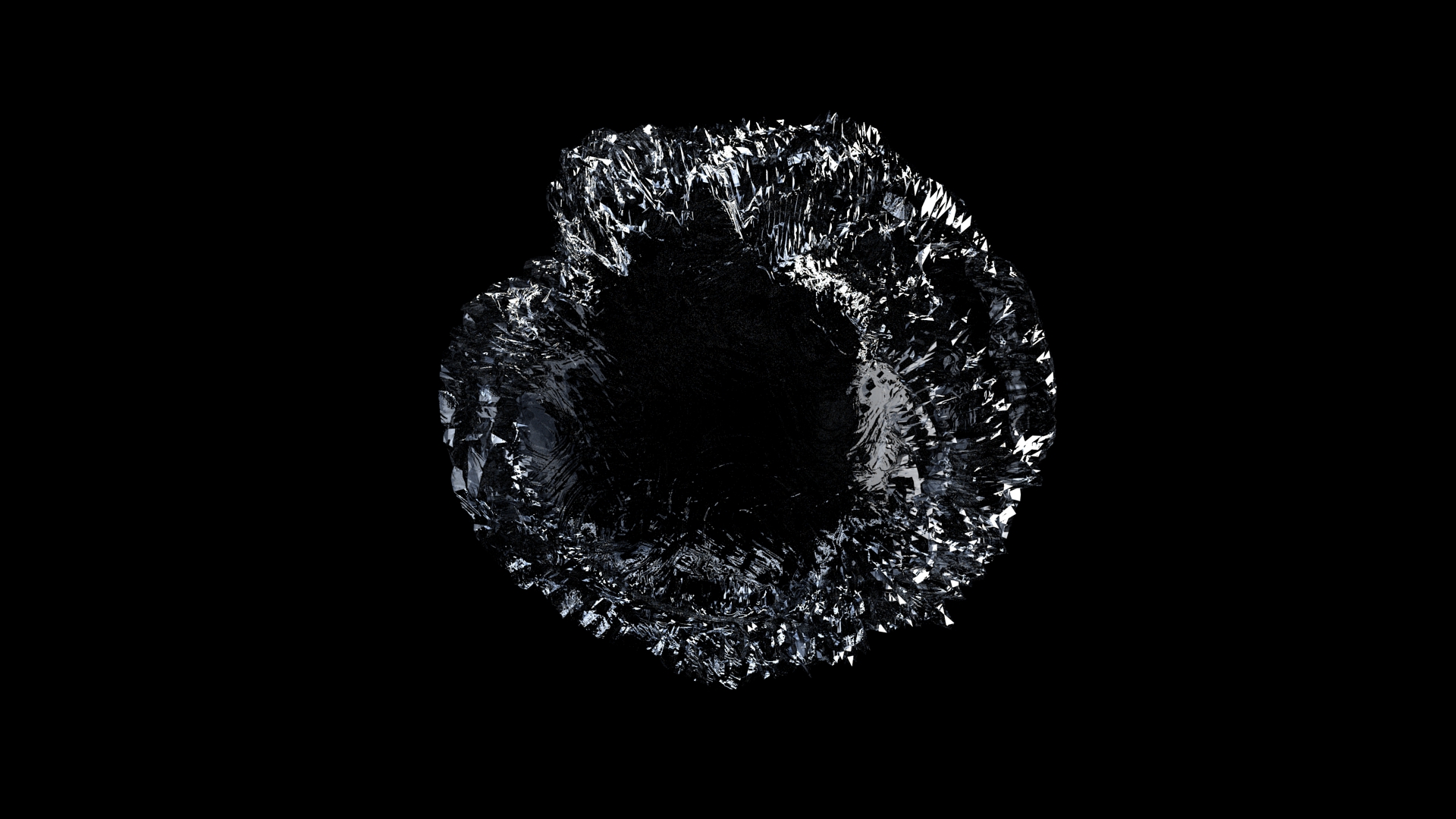

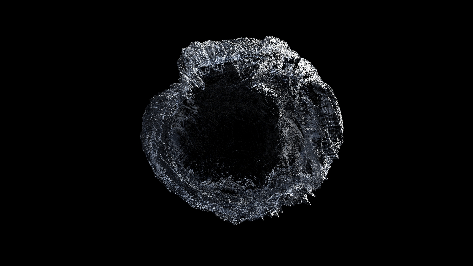

Subdivision: Modify the object's number of subdivisions before displacement occurs. Higher values produce more accurate results.
                                                  Figure 4. Subdivision: 2
                                                  Figure 5. Subdivisions: 6Texture: Upload a texture map. Colored images will be mapped as grayscale.

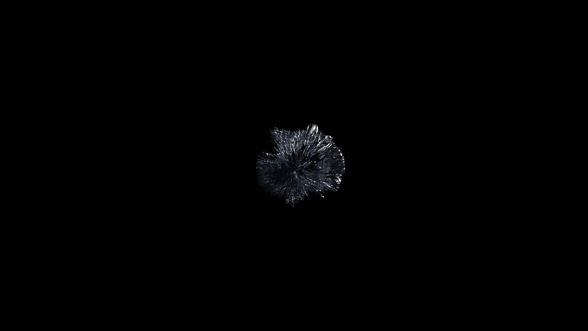

Height: Set the maximum distance displaced. For displacement to appear, values must be greater than zero; the default is 2 cm.
                                                  Figure 6. Height: 0.5cm

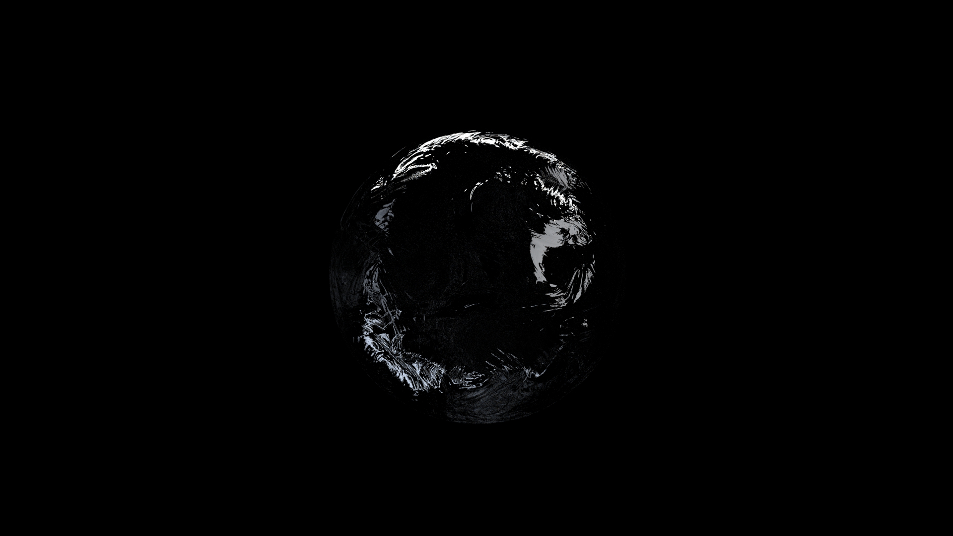

                                                  Figure 9. Center: 0.1cmNormal Smoothing: Enabled by default, to render smoothly (continuous shading). Disable to render in a faceted way, which is useful for rendering very sharp, detailed displacements such as sharp corners.
                                                  Figure 10. Normal Smoothing Disabled
