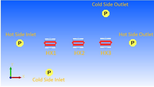

Step 1: Building Modelp
- Plan model setup based on number of passes
Figure 1.01: Sketch/Outline Heat exchanger model
- Drag and drop boundary Plenum chambers at the inlet and outlet locations for cold
and hot side as shown in Figure 1.01
- Translate (right click chamber/element → translate) option and manually editing the coordinates (Property Editor → Location), can be used to assist in placing chambers and elements in the right location
- Use
to adjust symbol and text size - Drag and drop three heat exchangers as we are modeling three pass heat exchangers

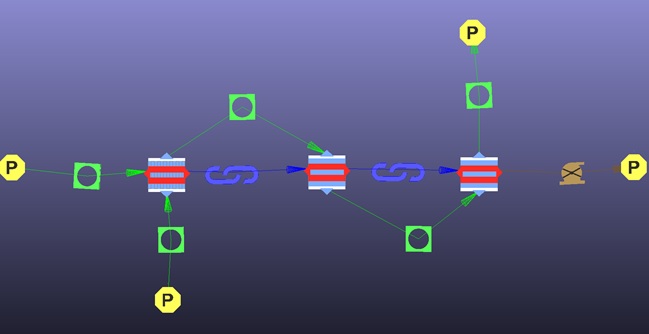

- Hot side:
- Connect incompressible conventional orifice elements between the inlet boundary plenum (left) and the first heat exchanger (HX1) to capture inlet manifold pressure loss
- Connect incompressible link element between the first (HX1) and second heat exchanger (HX2), between the second (HX2) and third heat exchanger (HX3) to transfer data between heat exchanger elements without any additional pressure or heat loss
- Connect incompressible fixed flow element between third heat exchanger (HX3) and outlet plenum chamber (right) to maintain fixed flow at hot side
- Cold Side:
- Connect compressible conventional orifice elements between inlet boundary plenum (bottom) and first heat exchanger (HX1) to model inlet manifold pressure loss, between third heat exchanger (HX3) and outlet boundary plenum (top) to model outlet manifold pressure loss
- Connect compressible conventional orifice element between first heat exchanger (HX1) and second heat exchanger (HX2), between second heat exchanger (HX2) and third heat exchanger (HX3) to model turning pressure loss
Figure 1.02: Compressible and incompressible orifice, fixed flow and link Elements Placement

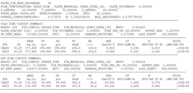

Step 3: Post-process
- Results file (*.res) should be generated in model running directory.
- open the result file (*.res) and search for HX element. Results for heat exchanger
will have following data
- Inlet and outlet information for cold and hot side of heat exchanger with
fluid properties
fluid properties
