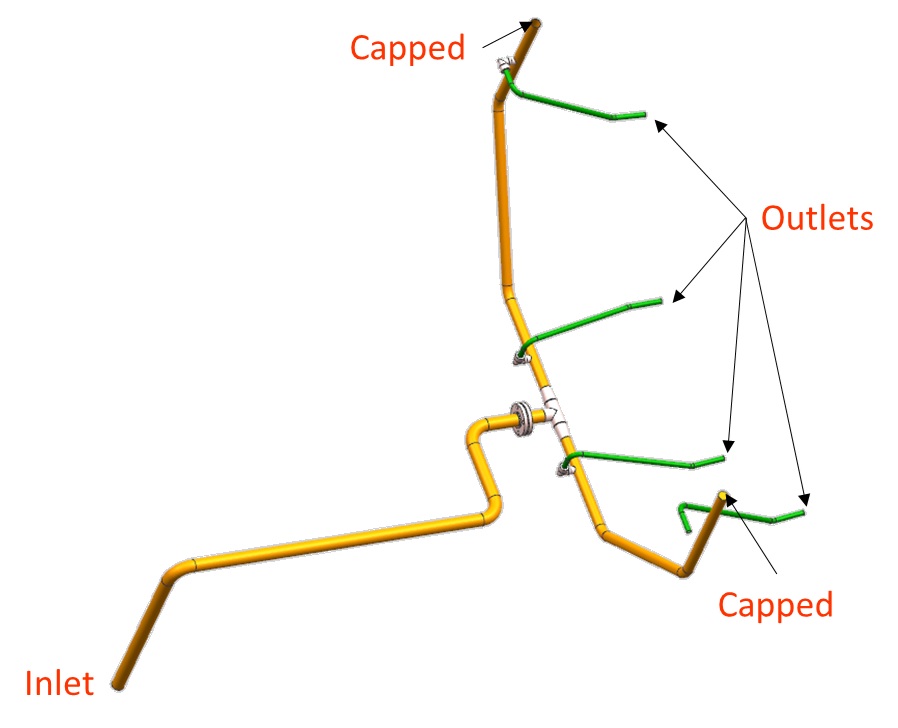

Step 1: Examine geometry and create plan
- The user will be creating a model of a water piping circuit shown in figure 1.01.
Figure 1.01: Water piping system
- The model begins with long runs of straight piping connected by 90-degree bends. It then splits in two directions and transitions into smaller diameter pipes, which then feed four spray nozzles.
- To model this piping system, the user will primarily be making use of tube, bend, and junction elements.

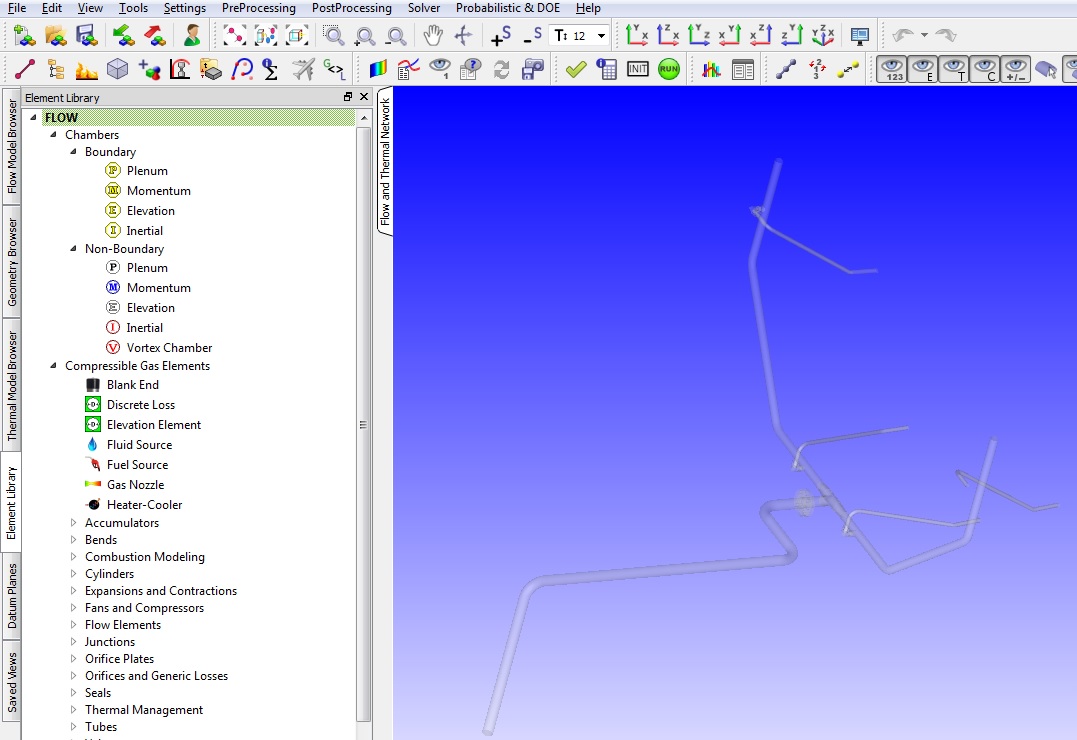

Step 2: Load IGES file
- Go to File → Load IGES File
- Browse to IGES location and select open (water_piping.igs)
Figure 1.02: Loaded IGES on default background

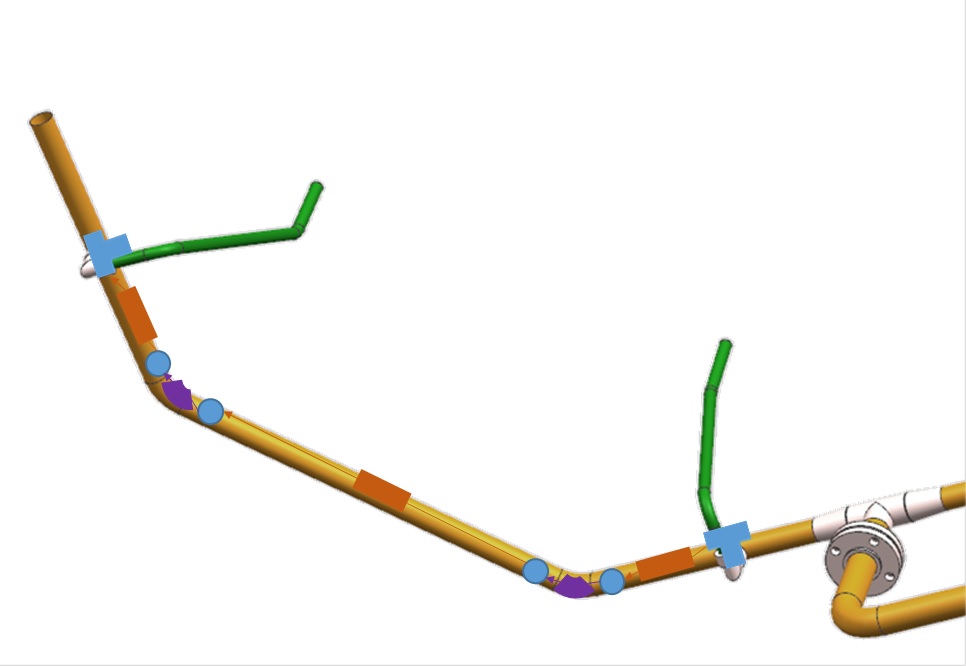

- Plan model setup based on what is known about the geometry
Figure 1.03: Sketch/Outline of model

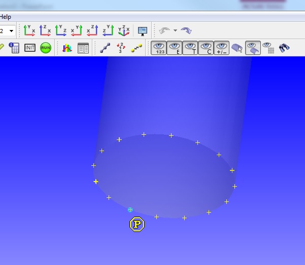

- Drag and drop Boundary Plenum chambers at the inlet and outlet locations from Figure
1.01
- Pressing and holding “Shift” while dragging chambers and elements enables snapping to IGES vertices for easier placement (Figure 1.04)
- Additionally the translate (right click chamber/element → translate) option and manually editing the coordinates (Property Editor → Location), can be used to assist in placing chambers and elements in the right location

Figure 1.04: Snapping to IGES vertices
- Click and drag non boundary momentum chambers to the locations (blue circles) in Figure 1.03

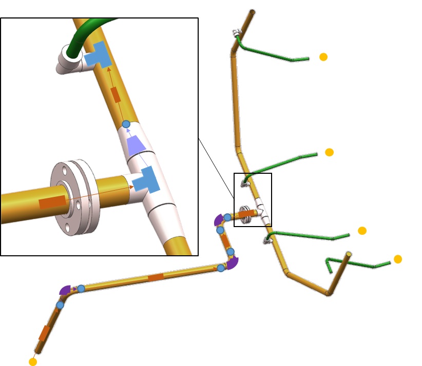

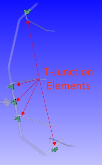

- Click and drag Incompressible T-Junction elements to the pipe connection locations in Figure 1.05
Figure 1.05: T-Junction element locations

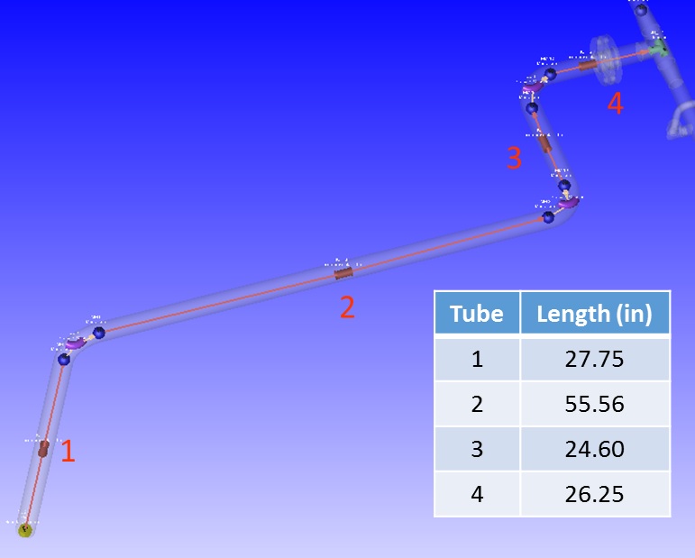

- For the piping leading up to the T-connection, use Incompressible Tube elements to connect the straight sections of pipe and incompressible Standard Circular Bend elements for the bends as shown in Figure 1.03
- For the tube elements, use the lengths shown in Figure 1.06.
- Set the number of stations to 10, check “Specified Diameter” under “Cross-Section Shape” and input a diameter of 2.07 in
- Under Segment Data, set Roughness to 0.0018 in and check “Adiabatic” for “Station Heat Transfer”
Figure 1.06: Tube Element locations
- For the Bend elements, set Bend Angle to 90 degrees, Bend Radius to 3.105 in, Diameter to 2.07 in, and Roughness to 0.0018 in
- After the T-Junction, place an Incompressible Conical Transition element, an Incompressible Tube element, followed by another Incompressible T-Junction as shown in Figure 1.07
Figure 1.07: Post T-Junction model set-up

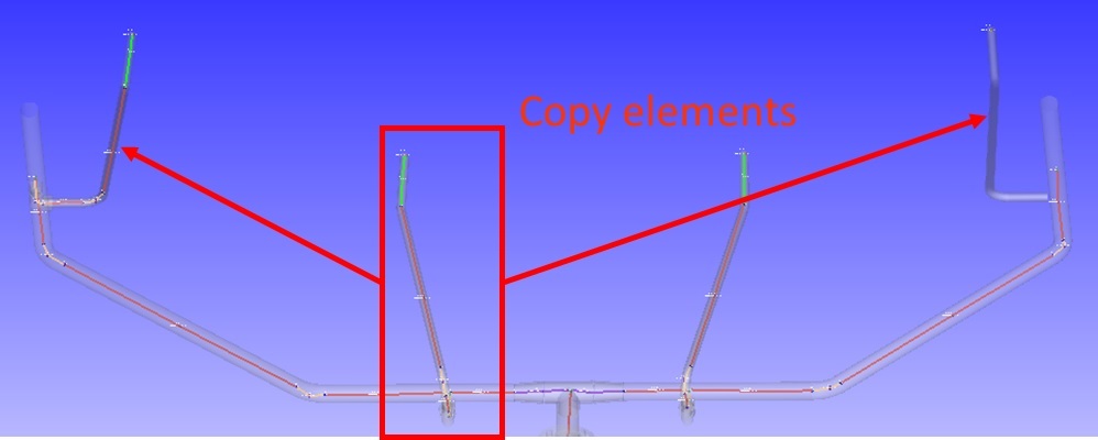

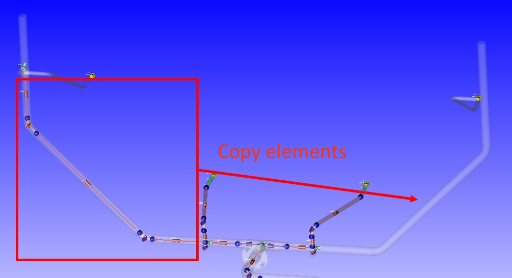

- At this point, since this is a symmetrical mode, it is possible to copy and paste
the elements, along with their inputs, from one side of the model to the other
(Figure 1.09)
- One method of doing this is by copying an entire branch of chambers and elements using “Shift” to select multiple entities and “Ctrl+C” and click at the desired location to copy and paste, followed by the use of rotate and translate to align with the IGES
- Additionally, placing momentum chambers and then individually copying elements one at a time is also an option (this may be easier to align with the IGES)
Figure 1.09: Copying elements with inputs due to model symmetry

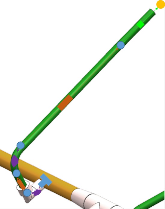

- Set up the remaining portion of the tubing as shown in Figure 1.10
Figure 1.10: Remaining piping set-up
- Place momentum chambers as shown (blue circles) in Figure 1.10 and connect them with Tube and Bend elements
- Place Incompressible Tube elements at the straight pipe locations. For the long tube
use a length of 36.36 in and for the two shorter tubes use a length of 14.15 in
- Set the number of stations to 10, check “Specified Diameter” under “Cross-Section Shape” and input a diameter of 1.5 in
- Place Incompressible Standard Circular Bend elements at the bends and set Bend Angle to 90 degrees, Bend Radius to 4 in, Diameter to 1.5 in, and Roughness to 0.0018 in

- To cap the model, drag and drop a boundary plenum at both non-nozzle ends, and use a
“Blank End” element to connect the plenum to the T-Junction element as shown on
Figure 1.13
- Set boundary plenums the same as the other outlet plenums
Figure 1.13: Use Blank End Element to cap model

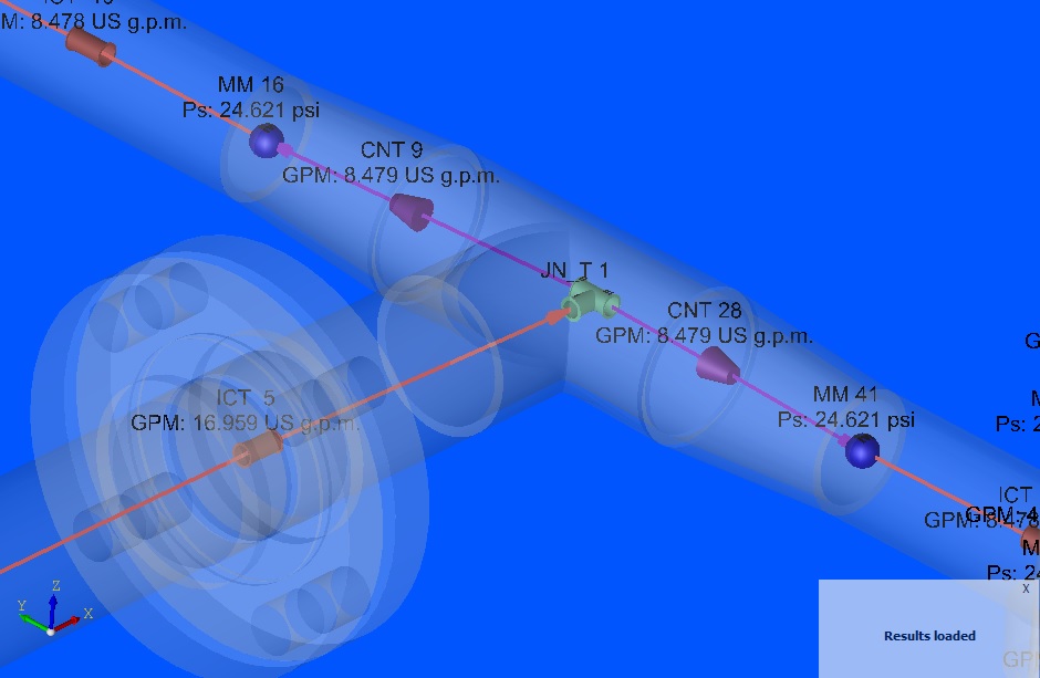

- Display the flow in GPM and the static pressure.
Figure 1.14: GPM and Static Pressure near Junction 1
