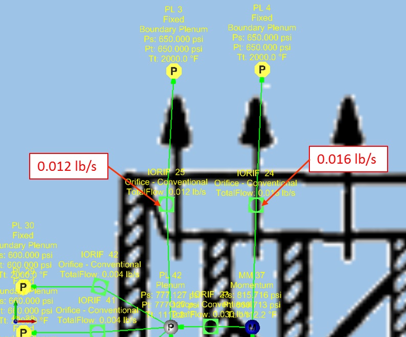

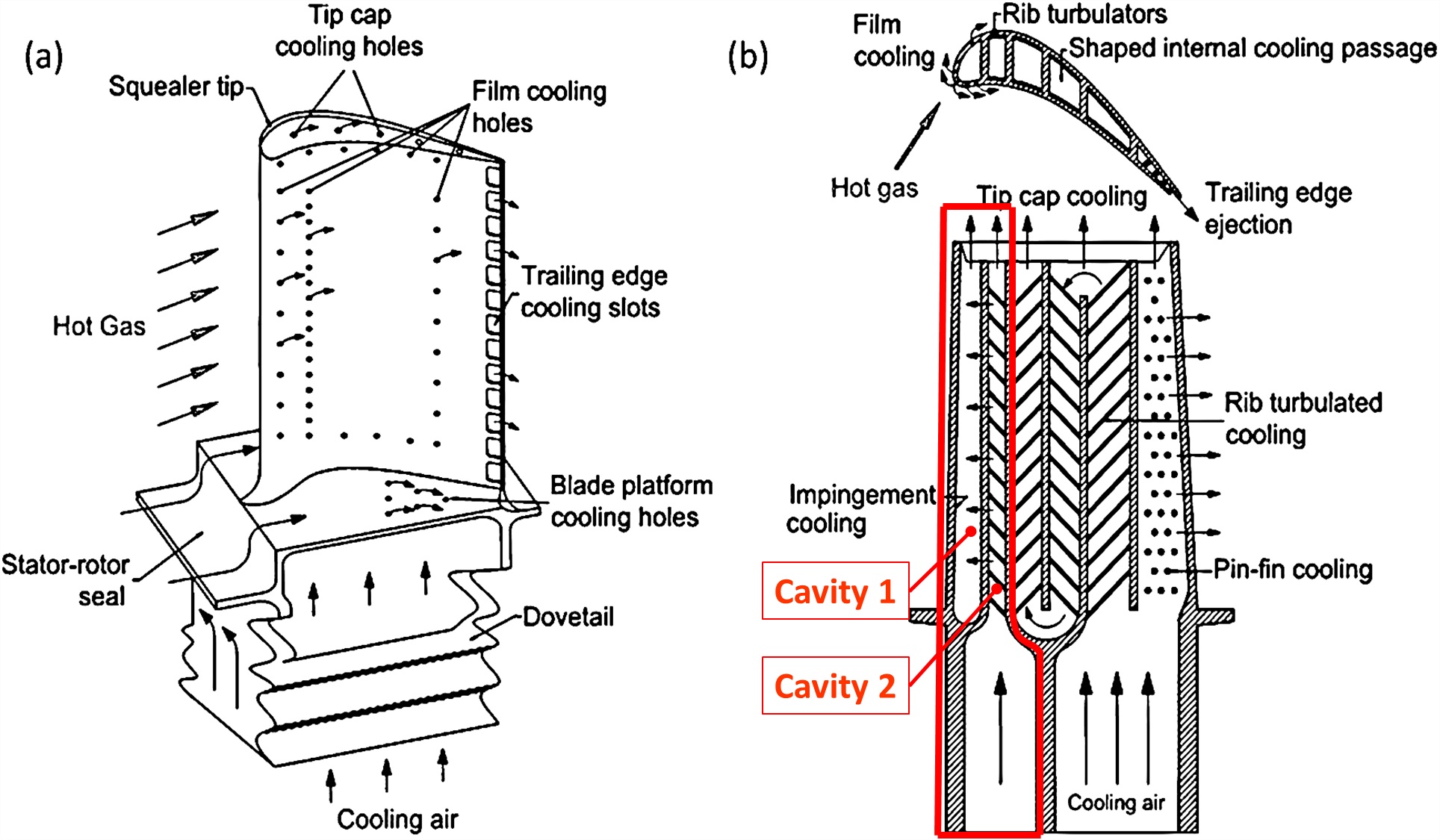

- The flow rates of the tip cap holes from the turbine blade model we created earlier, can be seen in Figure 1.02
- The goal of this exercise is to use PID Controller elements to distribute
the flow rate evenly, so that each hole has a flow rate of 0.014
lb/s

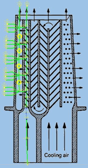

Figure 1.01: Turbine Blade Cooling Layout
Figure 1.02: Tip cap hole flow rate from previous example

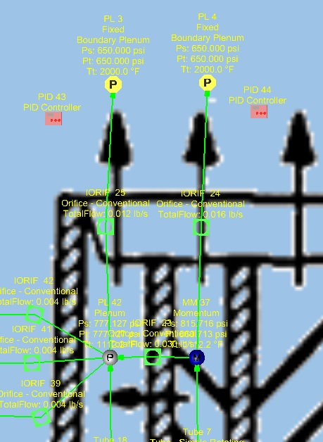

- Start by opening the previously created blade model
(Model_Exercise_7_start.flo)
Figure 1.03: Rotating Cooled Turbine Blade

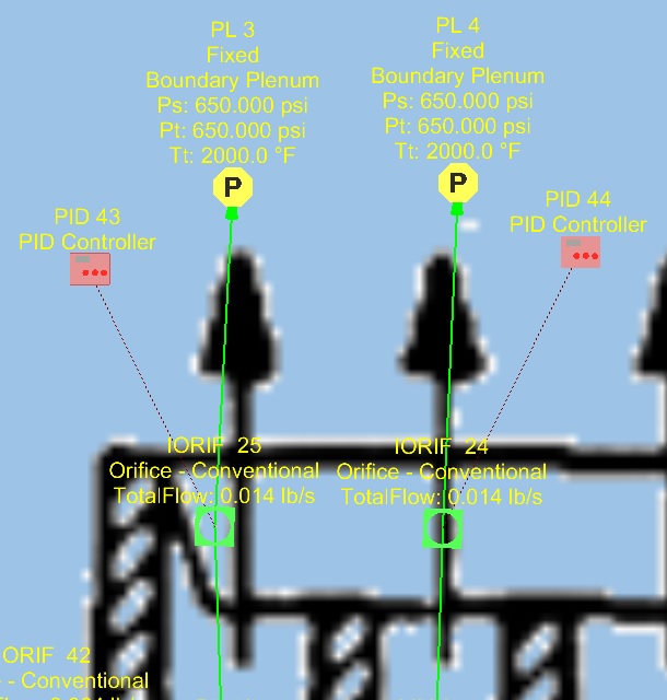

- Place a PID Controller Element next to each of the two conventional orifice elements
representing the tip cap cooling holes
Figure 1.04: PID Controller element placement

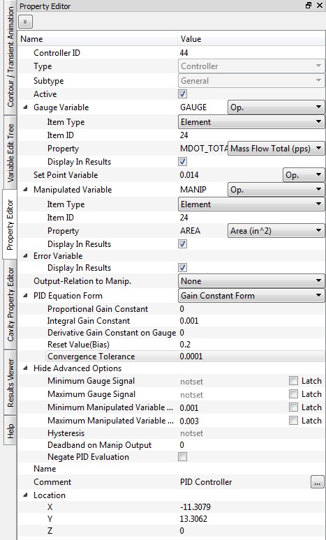

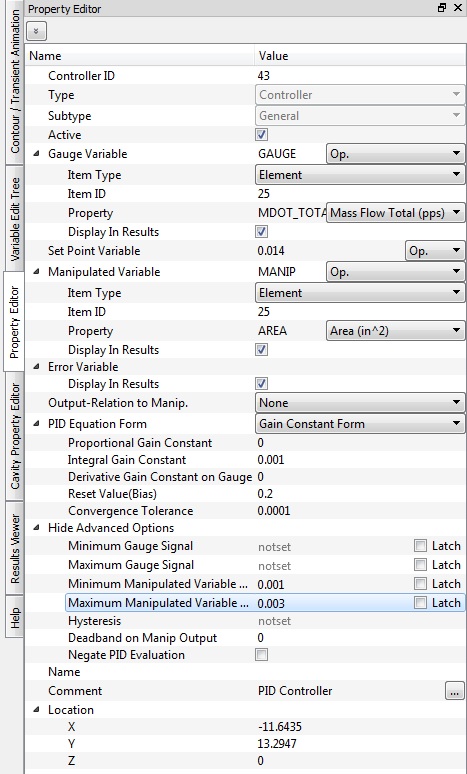

- For the left PID controller
- Set Gauge Variable → Item Type to Element
- Set Gauge Variable → Item ID to the element ID of which measurements will be taken from (in this case: 25)
- Set Gauge Variable → Property to Mass Flow Total (pps)
- Set Gauge Variable → Set Point Variable to 0.014 (this is the flow rate that the controller will try to achieve)
- Set Manipulated Variable → Item Type to Element
- Set Manipulated Variable → Item ID to the element ID of the element that will be changed in order to achieve the goal flow rate (in this case: 25)
- Set Manipulated Variable → Property to Area (in^2)
- Set PID Equation Form → Integral Gain Constant to 0.001
- Set PID Equation Form → Reset Value(Bias) to 0.2
- Set PID Equation Form → Convergence Tolerance to 0.0001
- Set Show Advanced Options → Minimum Manipulated Value to 0.001
- Set Show Advanced Options → Maximum Manipulated Value to 0.003
Figure 1.05: PID Controller element inputs (left)
- Do the same steps for the right PID controller element
Figure 1.06: PID Controller element inputs (right)

Figure 1.07: Results showing the target flow rate of 0.014 lb/s has been achieved

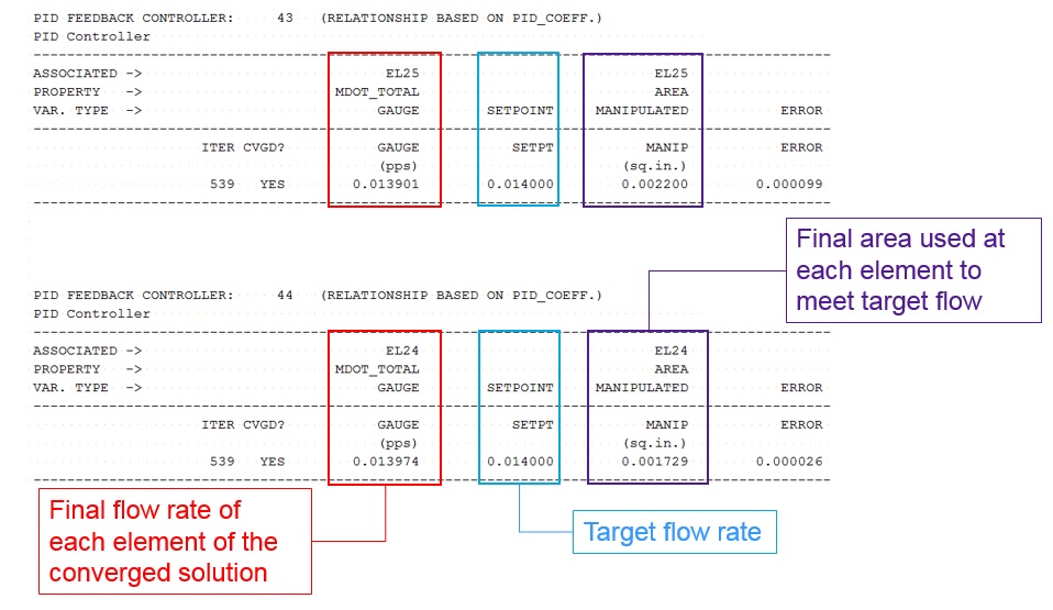

- Open the .res file in the run directory and scroll to the bottom for information on
the PID controller elements and to find out the area that was assigned to the
orifice elements in order to achieve the target flow
Figure 1.08: Results showing the area used to achieve the target flow rate at the bottom of the .res file
