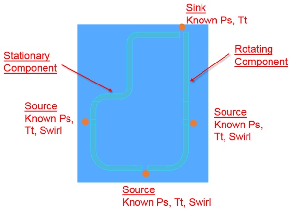

- Plan model setup based on what is known about the geometry
Figure 1.02: Sketch/Outline of cavity model

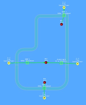

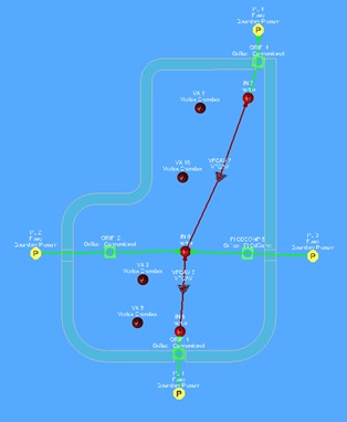

- Drag and drop Boundary Plenum chambers at the inlet and outlet locations from Figure
1.02
- Translate (right click chamber/element → translate) option and manually editing the coordinates (Property Editor → Location), can be used to assist in placing chambers and elements in the right location
- Use
to adjust symbol and text size - Place non-boundary inertial chambers at the center of the cavity and one at the top and bottom gaps
- Connect conventional orifice elements between the stator boundary plenum (left) and the center inertial chamber, between the bottom boundary plenum and the bottom inertial chamber, and between the top boundary plenum and top inertial chamber
- Connect a FI CdComp orifice between the rotor boundary plenum (right) and the center
inertial chamber
Figure 1.03: Initial model setup

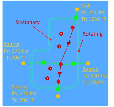

- Connect the inertial chambers with Forced Vortex (Cavity of present) elements
- Place Vortex Chambers at the locations shown in Figure 1.02
Figure 1.04: Vortex chamber and element placement
- For the three inlet boundary plenums
- Set pressure to 270 psi
- Set temperature to 700 F
- For the sink boundary plenum
- Set pressure to 250 psi
- Set temperature to 1050 F

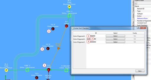

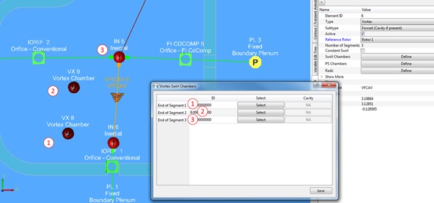

- For the bottom Forced Vortex element
- Set Number of Segments to 3
- Define Swirl Chambers as shown in Figure 1.05

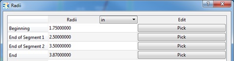

- Define Radii as shown in Figure 1.06
Figure 1.06: Bottom Vortex element Radii setup
- For the top Forced Vortex element
- Define Swirl Chambers as shown in Figure 1.07
- Define Radii as shown in Figure 1.08
Figure 1.07: Top Vortex element Swirl Chambers setup
Figure 1.08: Top Vortex element Radii setup

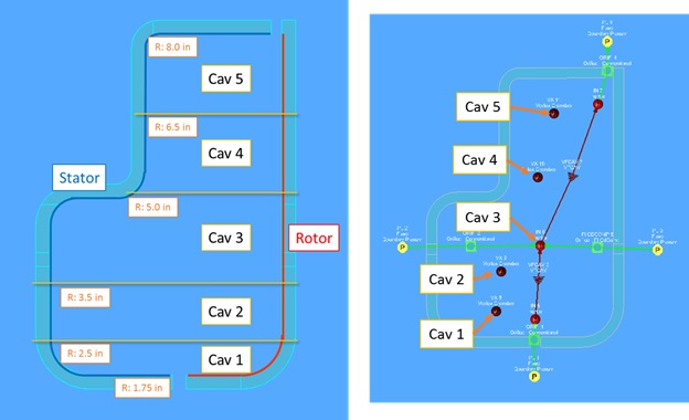

- Plan to configure cavities as shown below
Figure 1.09: Sketch/Outline of cavity setup

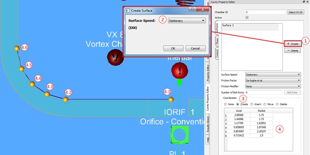

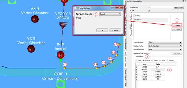

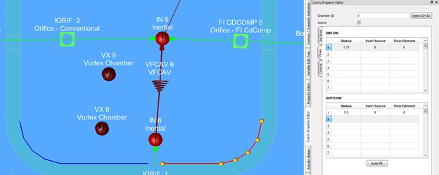

- Right click on the Cavity 1 vortex chamber and select Create Cavity
- Name it Cav_1 and click OK
- Go to the Cavity Property Editor
- Create a new surface
- Select Stationary from the dropdown menu and click OK
- Move the radial button to Create under Coordinates and click the locations shown in Figure 1.10 (After creating the point by clicking, the coordinates can be edited in the text box)
Figure 1.10: Creating stator cavity surface
- Follow the same steps to create the cavity 1 rotor surface, except this time select
Rotor 1 as the surface speed in the pop up box (Figure 1.11)
Figure 1.11: Creating rotor cavity surface

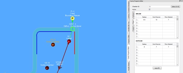

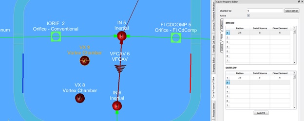

- Under Cavity Property Editor, select the flows tab and set it up as shown in Figure 1.12
Figure 1.12: Cavity 1 flows input

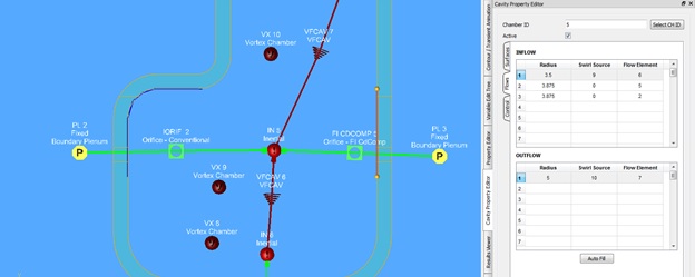

- Repeat these steps for the remaining four cavities and reference the pictures below
for input setup
Figure 1.13: Cavity 2 flows input
Figure 1.14: Cavity 3 flows input
Figure 1.15: Cavity 4 flows input
Figure 1.16: Cavity 5 flows input

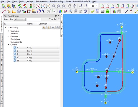

- Once complete, cavity setup can be verified by going to the Flow Model Browser tab
on the left and right click → Show All on Cavities. This will highlight the rotor
and stator surfaces as shown in Figure 1.17
Figure 1.17: All cavity surfaces shown

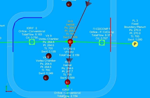

Step 5: Post-process
- Results file (*.res) should automatically be loaded into GUI. If not, it can be selected via File → Load Result File
- By default, both chamber and elemental results are displayed in the graphical workspace.
Figure 1.18: Cavity model results
