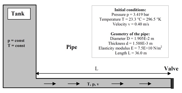

- The user will be creating a model for a piping system as shown in figure 1.01. The
tank will provide the fluid to the elastic pipe when the valve is open and if the
valve is closed, there will be pressure waves in the pipe. This is an example model
of how to generate a water hammer model.
Figure 1.01: pipe connection between a tank and a valve
Figure 1.02: Flow Simulator Model
- The tank has constant pressure and temperature; thus, it can be modeled as plenum chamber.

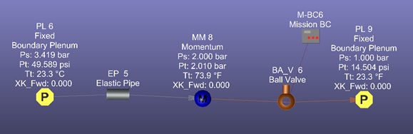

Step 2: Building Model
- Plan model setup based on what is known about the geometry
- Drag and Drop 2 Boundary Plenum chambers
- Inlet Plenum Boundary
- Ps = 3.42 bar
- Tt = 23.3C
- Exit Plenum Boundary
- Ps = 1 bar
- Tt = 23.3C
- Drag and Drop elastic pipe under Incompressible Liquid Elements section.
- Total Length = 36m
- Number of Stations = 20
- Diameter = 0.01905 m
- Wave Speed = 4000
- Roughness = 0.02999 mm
- And connect Ball Valve between elastic pipe and plenum chamber
- Pipe Diameter = 0.01905 m
- Valve Position(%Open) = 100

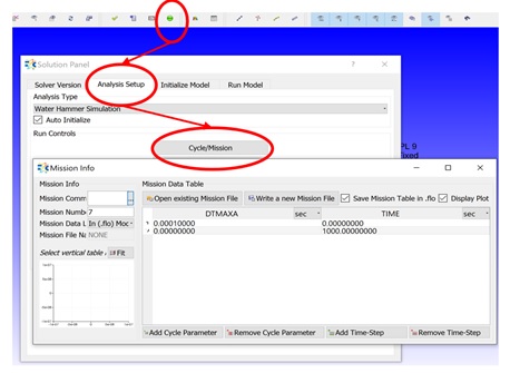

- Define Mission table for the controller (RUN → Analysis Setup →
Cycle/Mission)
- Drag and Drop Mission BC Controller to control Valve opening/closing through python
script
- GAUGE Variable is TIME
- GAUGE Variable Item Type is Mission
- GAUGE Variable Property is TIME
- MANIPULATED VAR. LIST Variable is VP
- MANIPULATED VAR. LIST Item Type is Valve Element
- MANIPULATED VAR. LIST Property is Valve Opening
- DEFINE Python Script to control Valve Opening base on TIME
- Select Analysis Type
- Run → Analysis Setup → Water Hammer Simulation

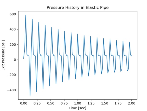

Will Be updated Soon. Interim Solution
Figure 5.02: Change in the Exit Pressure of the Elastic Pipe with time
