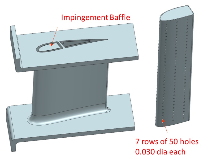

- The user will be creating a model of an air-cooled HPT nozzle as shown in figure 1.01. The HPT nozzle is exposed to air heated to high temperature by combustion just upstream. This is an example model of how the nozzle could be cooled to keep the material temperature within limits.
Figure 1.01: HPT Nozzle

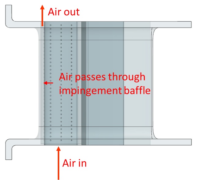

- Cooling air comes in through the bottom of the leading edge cavity and pressurizes the inside of the baffle, pushing the air through the impingement holes, and then exits through the gap between the baffle and the inside wall of the leading edge cavity at the top of the nozzle (shown in Figure 1.02)
Figure 1.02: Cooling air flow path

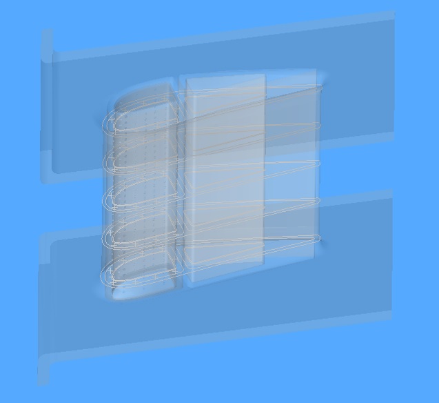

Step 2: Load IGES file
- Go to File → Load IGES File
- Browse to IGES location and select open (nozzle_model.igs)
Figure 1.03: Loaded IGES file

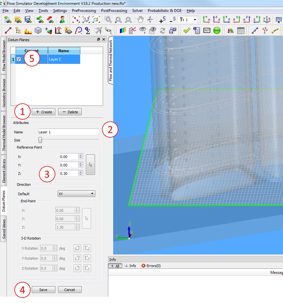

to adjust symbol and text size - Create a datum plane at the location of the first layer, so that chambers and
elements can easily be placed on the same plane (Optional)
- Go to PreProcessing → Datum Planes to bring up the Datum planes tab
- Click Create, name it Layer 1, and set the Z Reference Point to 0.3
- Click Save and check the box next to it to make it current (Figure 1.05)
- Unchecking the “Current” checkbox will enable the user to place chambers and elements anywhere on the model again
Figure 1.05: Creating a Datum Plane can help with placing Chambers and Elements on the same plane

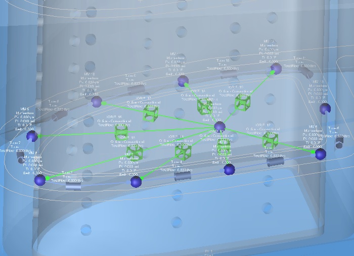

- Place non boundary momentum chambers around the inlet LE cavity as shown in Figure
1.04

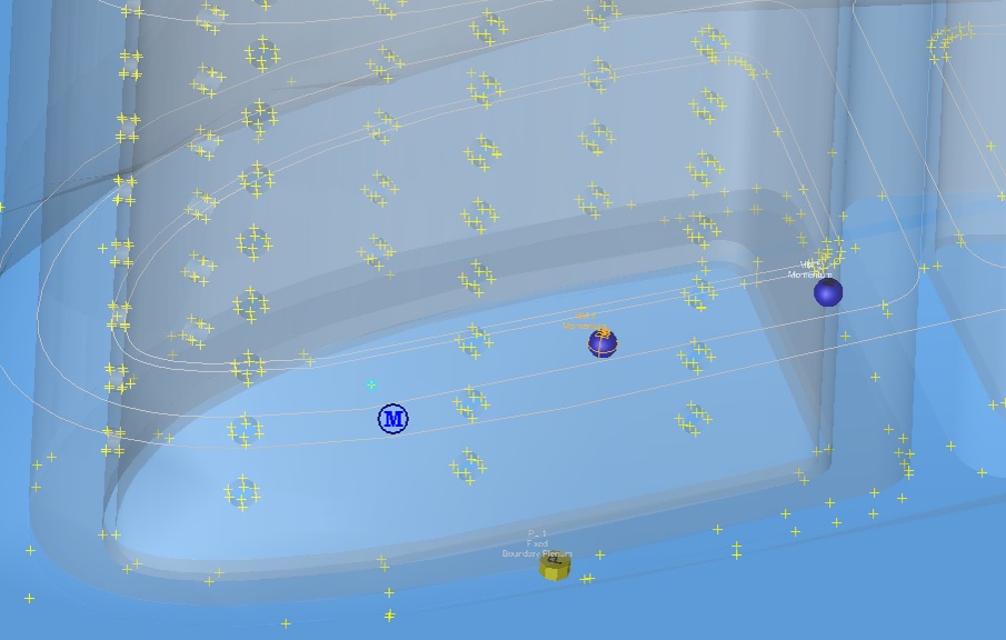

- Pressing and holding “Shift” while dragging chambers and elements enables snapping to IGES vertices for easier placement (Figure 1.06)
Figure 1.06: Snapping to IGES vertices
- Place a non-boundary momentum chamber at the center of the LE cavity
- Connect the momentum chambers between the baffle and the LE walls with Standard tubes. The direction of these tubes is hard to predict, but the Flow Simulator solver is able to reverse the flow direction if needed. You can create the tubes in the direction shown in Figure 1.04 or you can use your own directions.
- Connect the single momentum chamber at the center of the cavity to the momentum chambers between the baffle and LE wall with Conventional Orifice elements

- Select all tube elements and switch Geometric Input Choice from Hyd Diameter to
Area
- Set Area to 0.051 in^2
- Set Length to 0.2788 in
- Set Hide Advanced Options → Heat Addition → Wall Temperature to 800 F. This is to simulate some heat transfer to hot metal. The 800F is an estimate of the average metal temperature surrounding the tube. A more accurate method would be to create a thermal network to model the heat transfer.
- Select all Conventional Orifice Elements and switch Area/Diameter to Diameter
- Set Diameter to 0.03 in
- Set Cd to 0.8
- Set Hide Advanced Options → Element Multiplicity → No. of Streams Entering and Exiting to 10
- Set Hide Advanced Options → Element Orientation → Element Inlet Orientation to Other and set Tangential Angle to 180 degrees

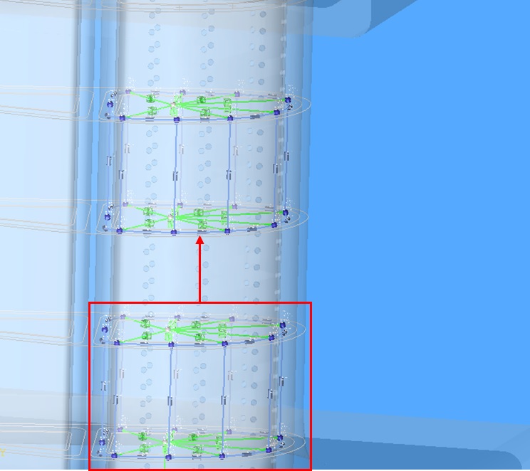

- Now that the first layer set-up is complete, the translate option can be used to
copy and position the next layer of chambers and elements (make sure to uncheck
“Current” from the datum plane tab if a datum plane was used for the chamber and
element placement)

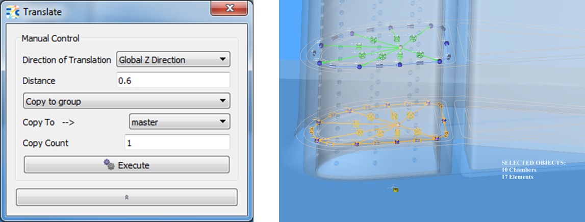

- Select all chambers and elements in the first layer and Right Click → Translate
- Press the down arrow
under “Auto Control” on the small box that pops
up - Set Direction of Translation to Global Z Direction
- Enter a distance of 0.6 in
- Change “No Copy” to “Copy to group” from the dropdown and click Execute
Figure 1.08: Copying chambers and elements using Translate

- Select the chambers and elements in layers one and two and Translate/Copy them to
layers three and four
- Select all chambers and elements and Right Click → Translate
- Enter a distance of 1.2 in
Figure 1.09: Copying layers 1 & 2 to layers 3 & 4

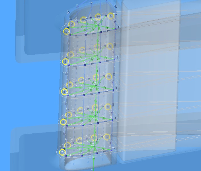

Figure 1.11: Reverse flow indicators
- The yellow circles around some of the elements (Figure 1.11) are indicating that the direction of flow is opposite to the orientation of the element
