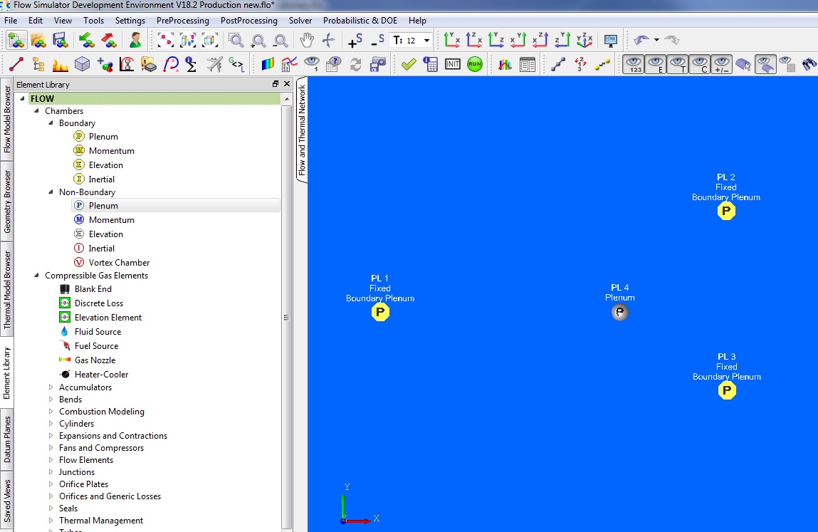

Step 1: Create Model Entities
- Drag and drop three boundary plenums and one non-boundary plenum from the Object Tree to the Graphical Workspace. See figure 1.02
Figure 1.02: Simple Stationary Model Chamber Layout

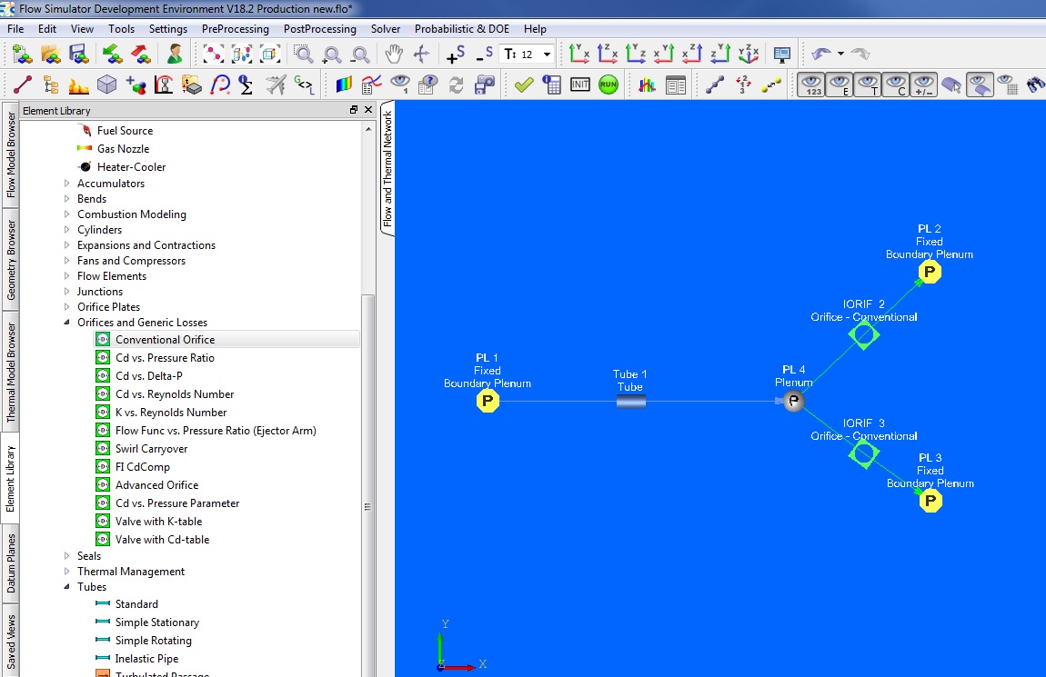

- Drag and drop tube element, and connect upstream chamber to boundary chamber 1, and downstream chamber to non-boundary chamber 4.
- Drag and drop two orifice elements, each one connecting upstream to non-boundary chamber 4 and to each of the remaining boundary chambers. See Figure 1.03.
- Save new model database by selecting File → Save As, and specifying a filename.
Figure 1.03: Simple Stationary Model, Chambers and Elements

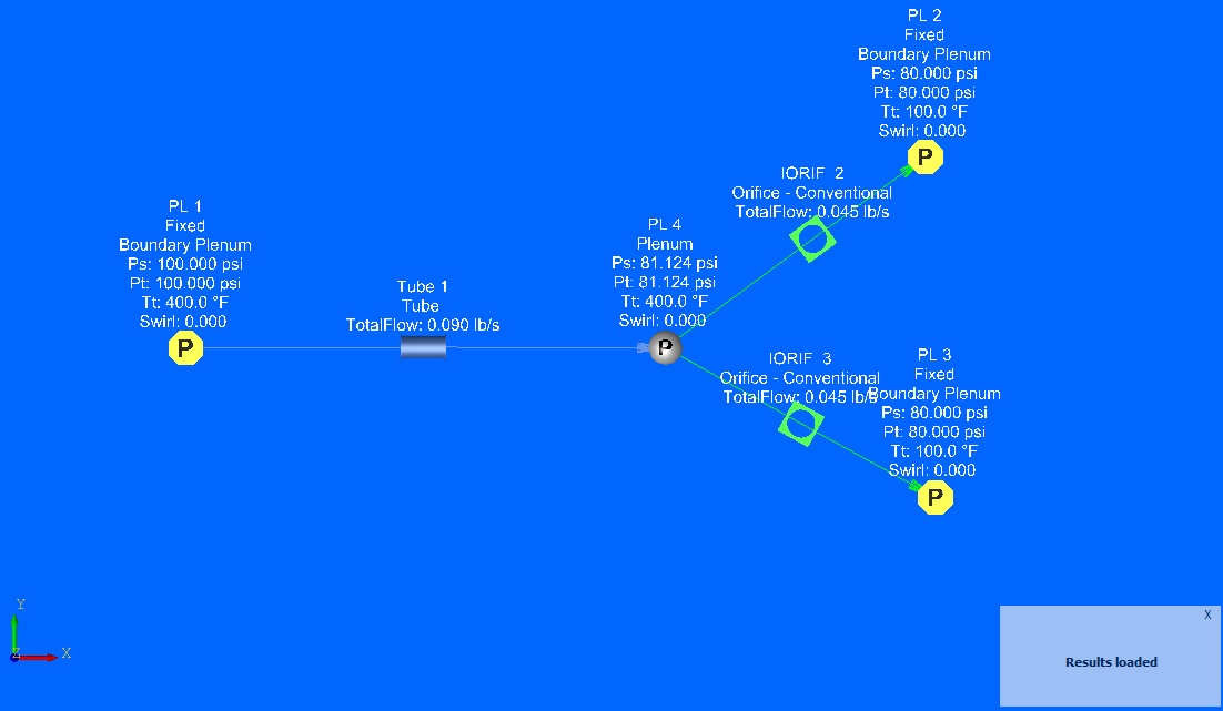

Step 4: Post-process
- Results file (*.res) should automatically be loaded into GUI. If not, it can be selected via File → Load Result File
- By default, both chamber and elemental results are displayed in the graphical workspace. See Figure 1.04.
- Customization of the displayed results is accessible within Settings → Display Options
Figure 1.04: Simple Stationary Model w/ Results Displayed
