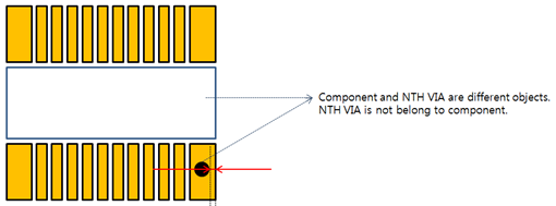

  • NTH Via and Overlapping Pad’s Size Checking: If SMD components pad and non-through holes are overlapped, gab between hole and pad should be reserved.
    • Target Component Group: Select the target component group from the list.
    • Minimum Gap between Via hole and Pad: Set the minimum distance value between component pad and NTH Via.
